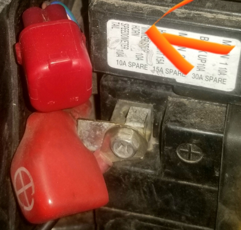

I cannot seem to locate any info on it. It looks like the alarm plug that is normally capped on a china scoot. It looks like i can plug a moto alarm right in. Any hepz is greatly appreciated. Thanks

If I remember correctly that is a relay. I have a 2013 model and I have worked on it many times, but I can't remember what I discovered that it belonged to. I will have to refresh myself sometime just so that I can remember it.
If I remember to, I will look it up in my service manual.
Re: What is the little red capped plug next to the battery?
Now I remember.. It is part of the fuel management system.. It is the odb2 port.
Mel46 wrote:Now I remember.. It is part of the fuel management system.. It is the odb2 port.
It might be a fault sensor reader pick up point but it isn’t an obd2 port.

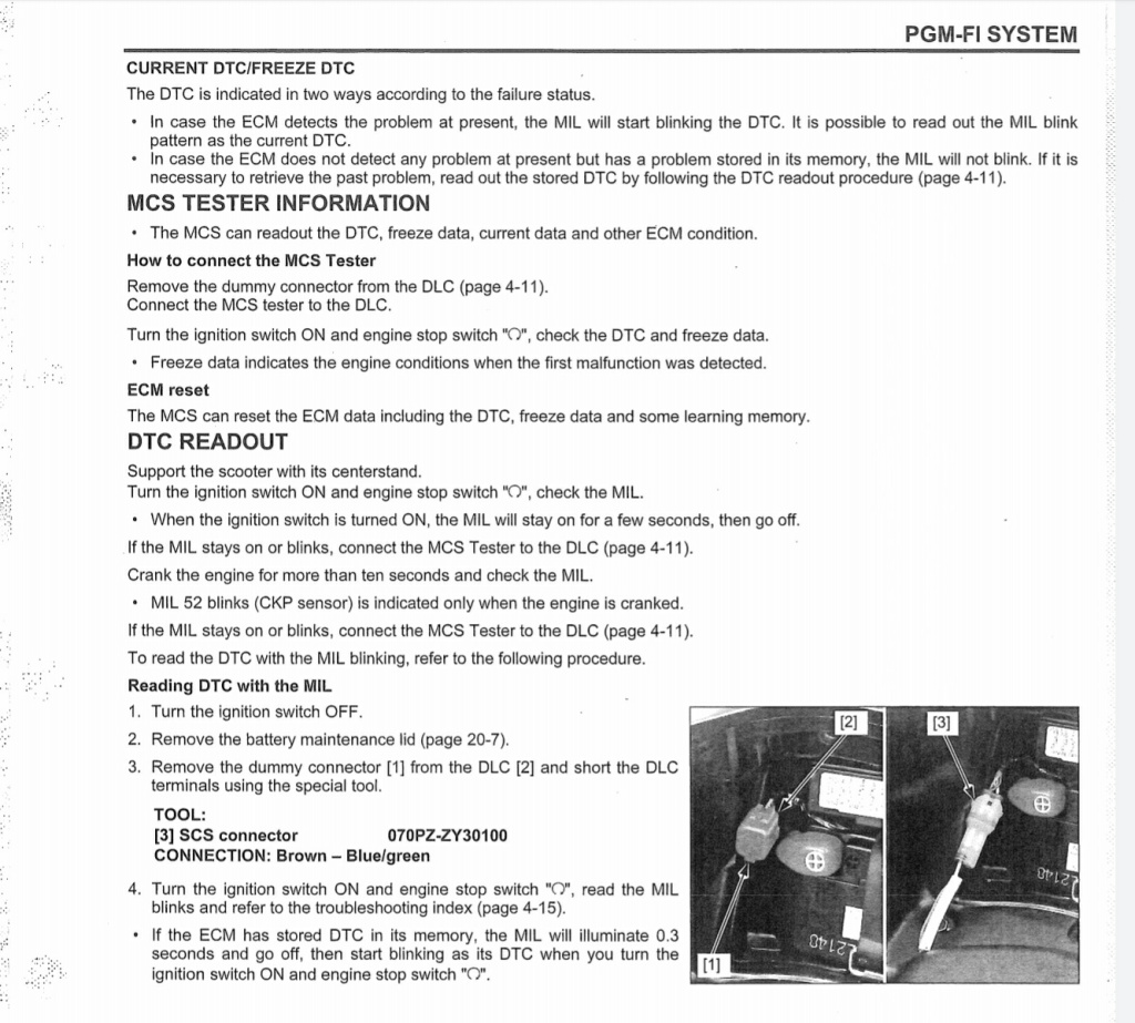

You You is correct. The Service Manual calls it the Data Link Connector (DLC). Page 4-12 says that you can use it for ERASING the DTC (Diagnostic Trouble Code).
If you have a Service Manual, this page might give you more information about it. Chapter 4, page 11 (4-11).
That is the DLC connector. One can diagnose ereor codes through it either with, or without a comouter.
Also allows monitoring certain ooeration parameters with a simple obd connector mated to a Bluetooth dongle capable of K-line comms, and an app on a mobile phone. This is for example how I used to tune the variator on my new 2019 pcx without pgisically attaching a tachometer.
