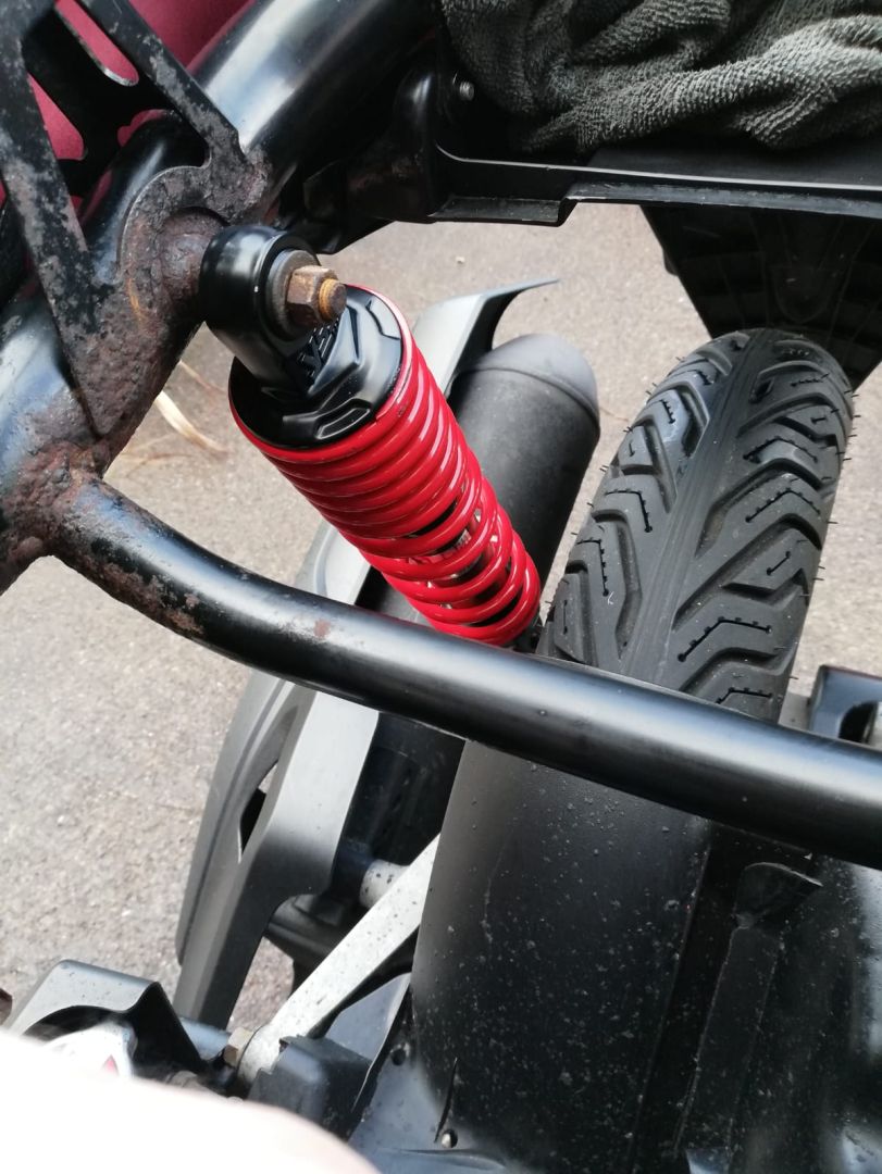

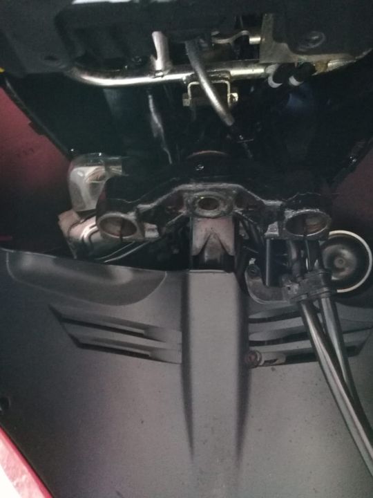

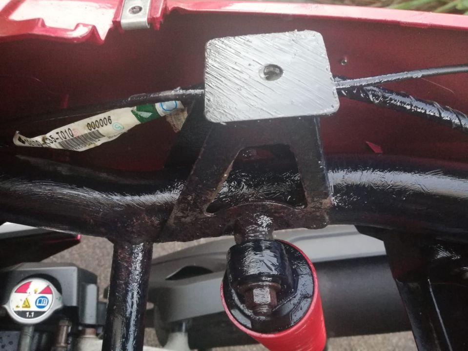

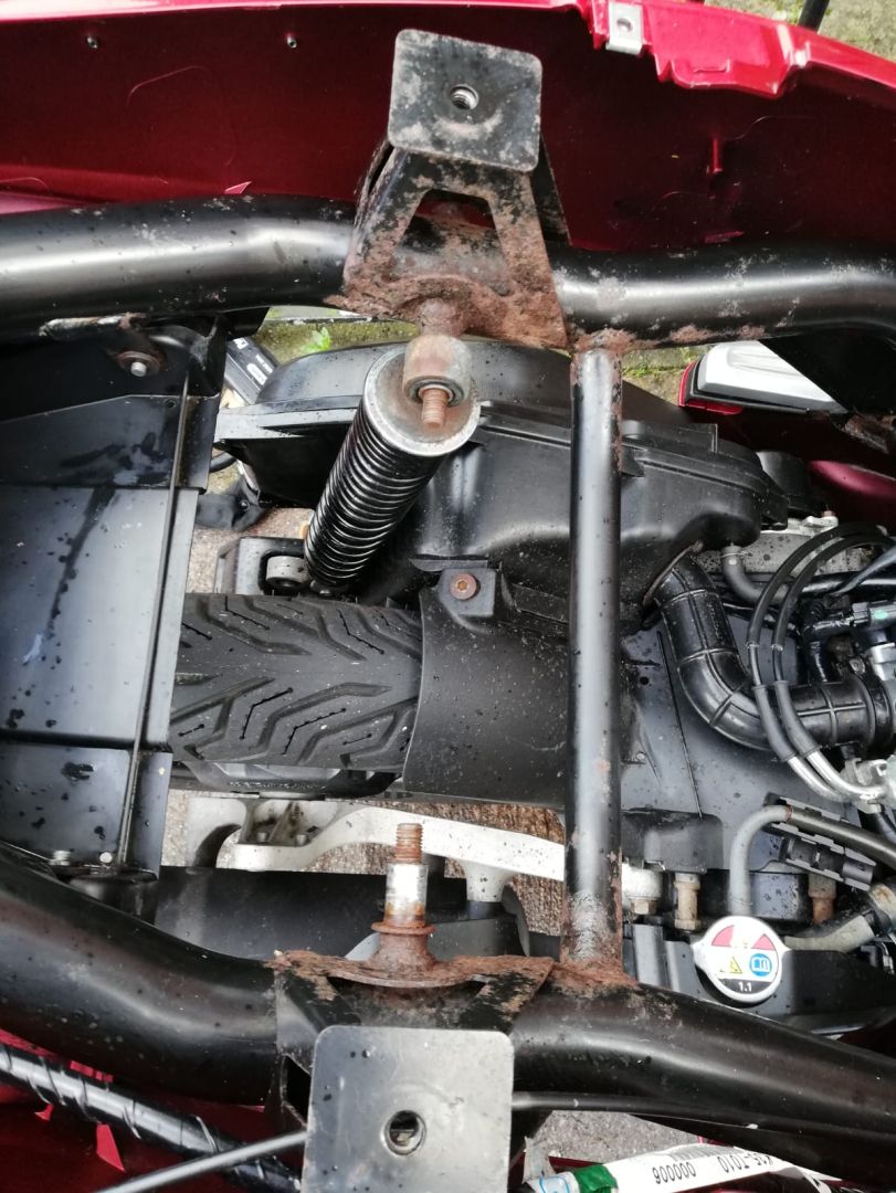

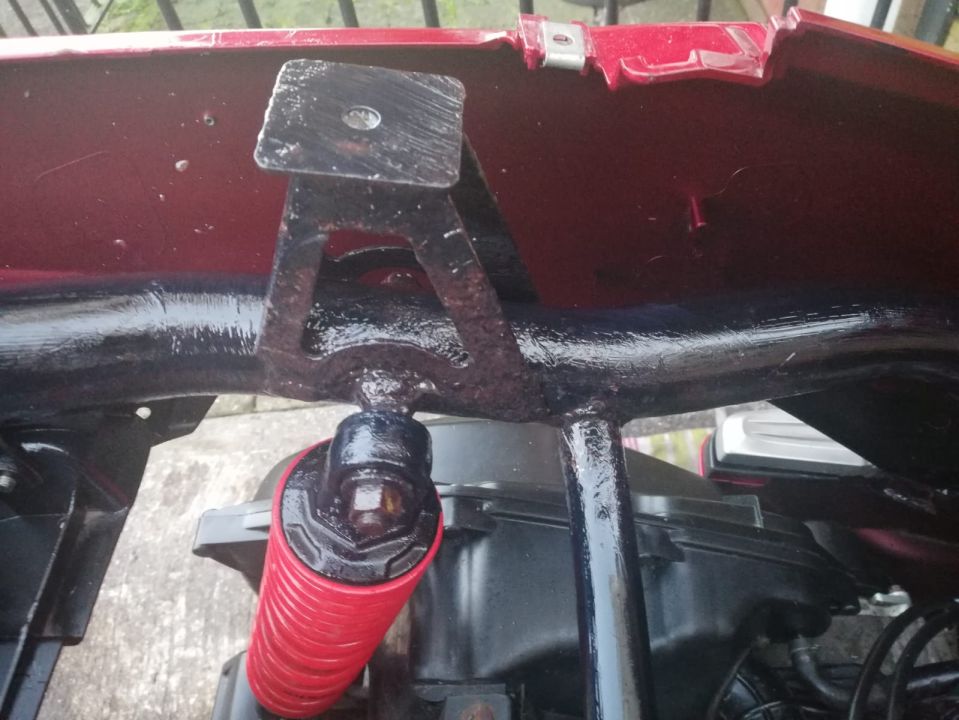

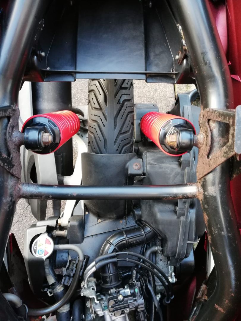

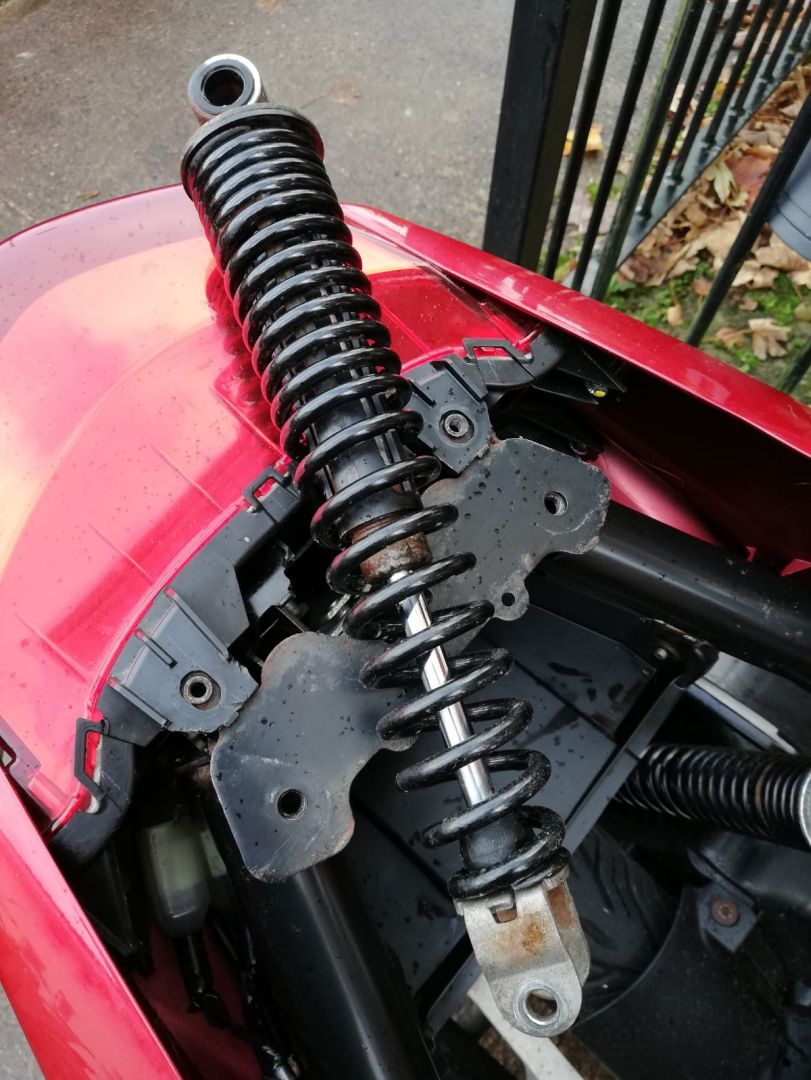

Waiting for Epsilon hurricane I've give it a go, cleaning engine bay and changing the shock absorbers.. very smooth process except the removal of pre fitted absorber's metal bushing guides. As you can see from pics old units has no netal guides, which are directly biuld on the top frame mounting points.
More stiff and under control experience, sensation are very Positive, but remain to check spring preload set and replace fork oil for a better balancement.

Also, could I just spray paint the rusted frame points or I should use a rust converter?
TIA,
Adrian
I will give you all an update in the next days with a more extensive ride test and eventually the Fork oil change too.
TIA,
Adrian
- Posts: 1836
- Year: 26 adv 160
- Location: Fort lauderdale
Re: YSS Shock Absorbers
Wire brush , alcohol wipe, then rust converter. Great stuff....
Paint after removing the rust, either by hand or using the convertor.

I didn't see any shock obsorbers but I am shocked. That rust !

Irish weather, wet 300 days a year

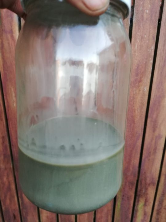

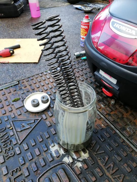

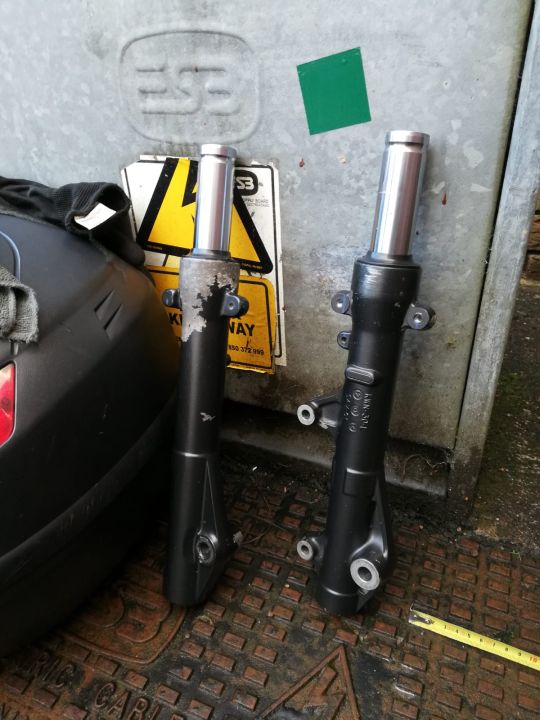

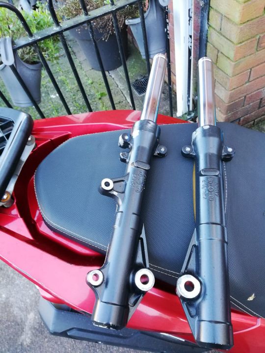

Sorry for the delay guys, bad weather for 3 weeks, finally today I was able to change the Fork oil, what a difference and what crap there was inside.. look there
- WhatsApp Image 2020-11-21 at 17.30.17 (2).jpg (80.18 KiB) Viewed 13261 times
- WhatsApp Image 2020-11-21 at 17.30.17 (1).jpg (39.48 KiB) Viewed 13261 times
- WhatsApp Image 2020-11-21 at 17.30.17 (3).jpg (65.29 KiB) Viewed 13261 times
- WhatsApp Image 2020-11-21 at 17.30.17.jpg (36.44 KiB) Viewed 13261 times
- WhatsApp Image 2020-11-21 at 17.30.17 (4).jpg (93.18 KiB) Viewed 13261 times
Looks like an emulsion.
What weight fork oil did you use?

It's a Castrol fork oil 15w mineral based and probably I will change it again in few months when I will paint the forks too whch seems to need attention.

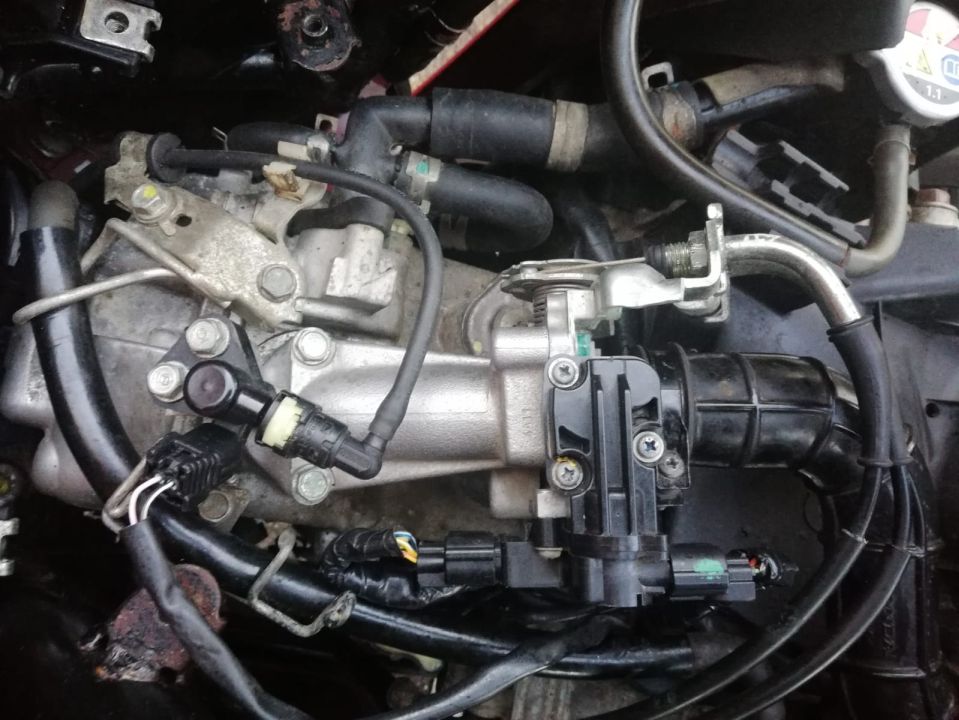

Today I will brush and sand the rusted frame points and treat with some rust converter before painting and asap clean the throttle body and the injector

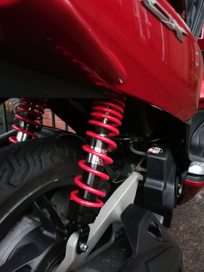

Small delay again due to weather conditions.. throttle body and injector cleaned with Wynns Carb cleaner and Frame treated with rust converter.
Excellent results in terms of engine response, now giving gas has an immediate response despite the fact it was not too dirty tbh.
Front fork now are more balanced with the rear Yss shock absorbers set on the low spring rate, but remain much more stiff than the original, so keep it in mind if you are considering this way. The only possibility is in a few miles could get a bit softer, I will let ya know.
Has a been a long journey, but despite few difficulties related to the lack of few tools, has been a real pleasure to play with it and very straight forward process for an inexperienced like me.
