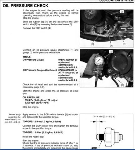

Hi can anyone tell me where the oil pressure switch is on a 2018 Honda Forza 300 I want to change it.

ronslaverda wrote:Hi can anyone tell me where the oil pressure switch is on a 2018 Honda Forza 300 I want to change it.
This should help:
Snap 2020-11-06 at 13.38.29 (Small).jpg (38.4 KiB) Viewed 1604 times
Looks like it's by the oil filter. They call it an EOP

@ Limey, Do you have a maintenance manual for the 2018 Forza 300 or where do you get those pages?

Yes - I bought a maintenance manual, although it is for the 2014-2016 model. I imagine the 2018 one would be in a similar location.
Copyright does not allow sharing the whole thing, but I reckon a bit here and there won't hurt!
