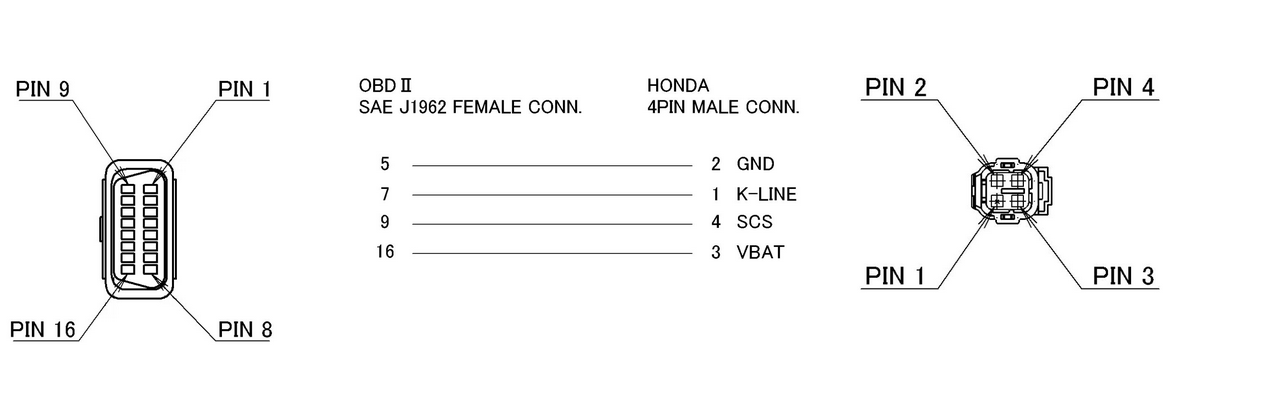

Not many have success - in past entries about this, someone says it works and others then have no luck at all getting their bits working on the PCX. Sometimes I believe it's a wiring issues as many of the connection diagrams off google search dissagree with one of the connection wires / functions - it seems it's not %100 standard at times.Oyabun wrote:I use a cheap Ebay special small blue color Bluetooth dongle.
Re: Fault Code Reader
Im able to get power to my dongle but it gets no data. I think it is a wiring issue.
Saved this diagram some months back - not sure it's the correct wiring or not.
- obd2.png (71.96 KiB) Viewed 8981 times
