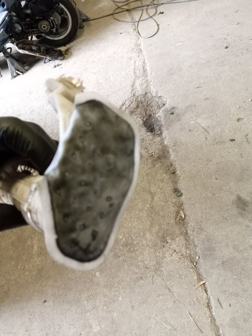

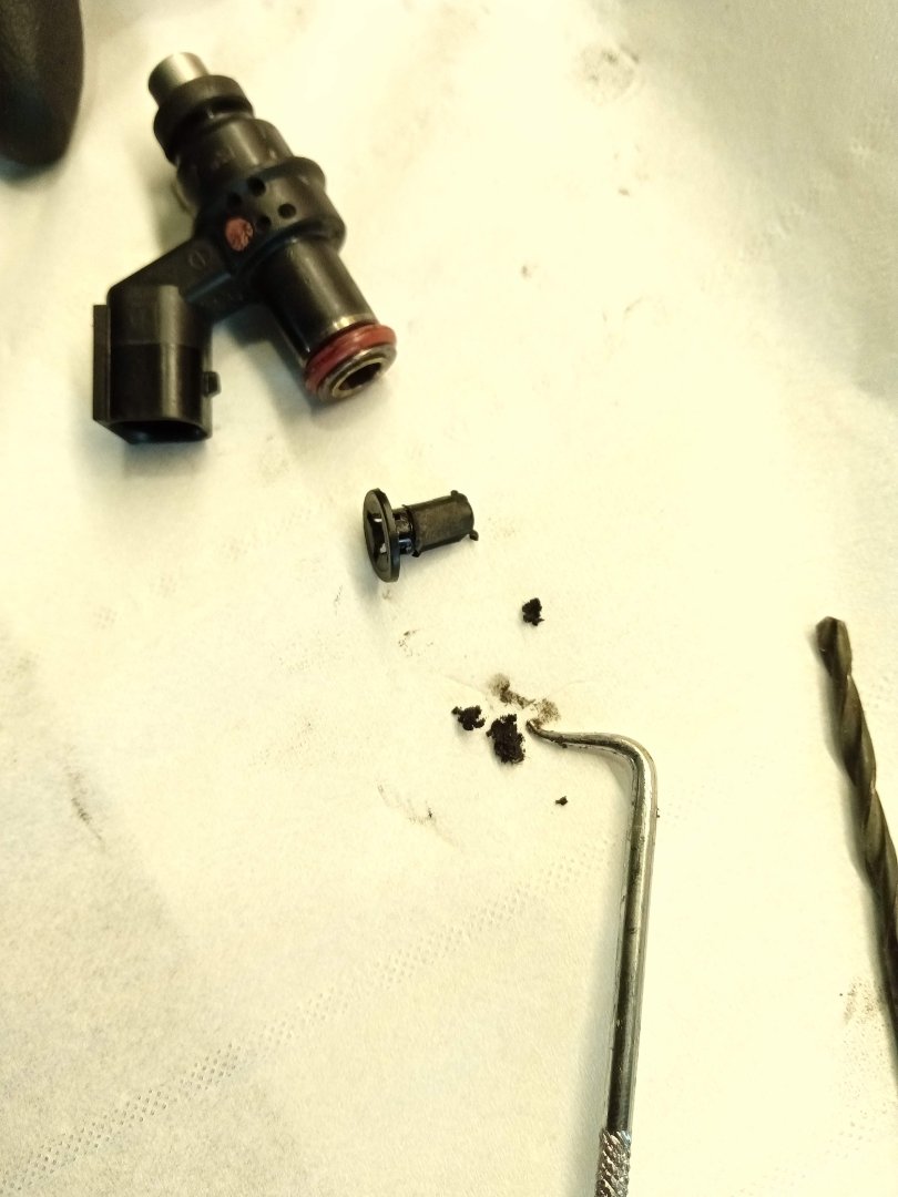

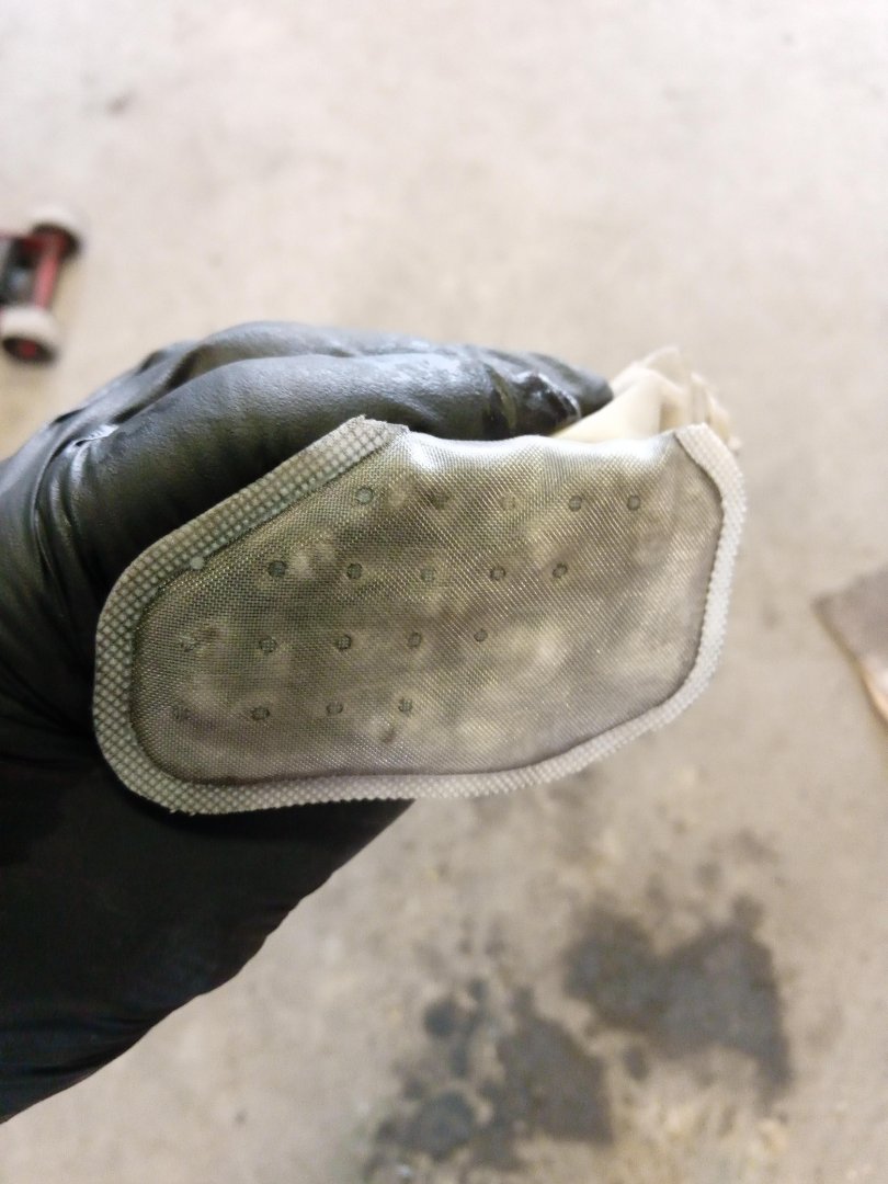

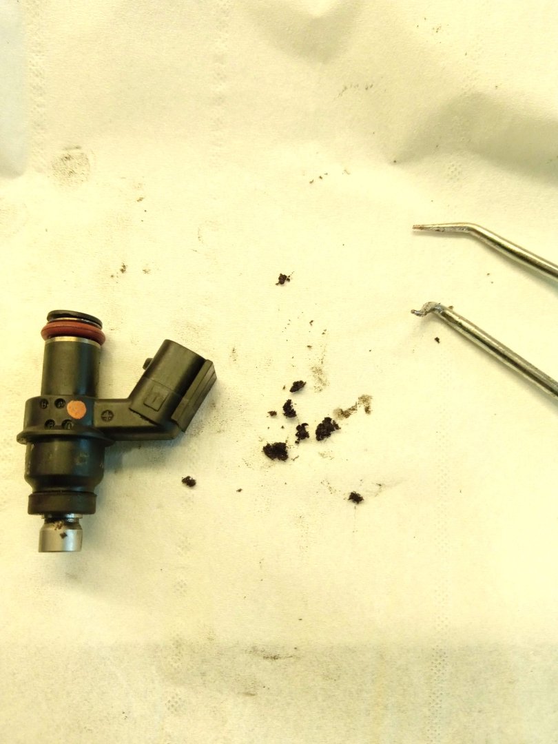

power-full
Posts: 280
Year: 2010
Color: preta
Re: Scooter cranks but does not start (sometimes)
Post by power-full »
Good Morning. I had something like that... it would catch on and it was barely slow and even then it would go down...change the tow bike home and start doing a test... I always thought it was the gas pump... when I went to see the injector was completely clogged .. it was just clean and so far I have never had any stress.
gas pump before washing,

power-full
Posts: 280
Year: 2010
Color: preta
Hello good Morning . here is the video I made to test the gas pump. as I saw that it was good, I changed the butterfly and the complete injector... the bike was immediately good.... so I went back and changed it by phases. (I changed the body of the butterfly (I assembled the original), and the tube was fine, I changed the injector (original) and we have gutters again... that is, it was my problem.... when I looked with eyes to see is that I noticed that the injector network was not visible ..hence these photos ....
