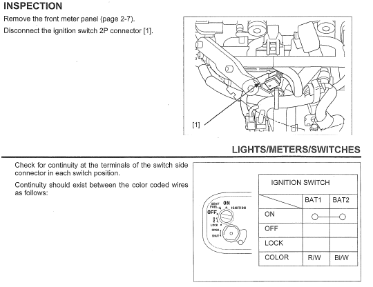

I'm thinking faulty ignition switch (or as the service manual calls it combination switch for the after 13' models).
You could remove a lot of panels to check the switch for continuity as the SM suggest see image below:
ignition switch.png (56.35 KiB) Viewed 2919 times

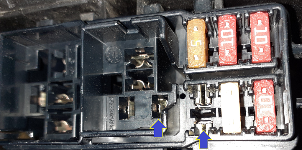

Or - I looked at the electrical wiring diagram and you can also test for this continuity by:
* Disconnect the battery first!
* removing the ign. fuse (10A) and the main relay in the fuse box.
Next measure the continuity between the two points indicated with the blue arrows in the image below I just took now from my own pcx.
ignition continuity test.png (1.04 MiB) Viewed 2919 times
With the key completely in the off state it should read an infinite resistance, with the key 1 click turned it should still be infinite. Once the key is fully turned you should see a resistance of 0.
If this is not the case you should have a look at the ignition switch/combination switch.

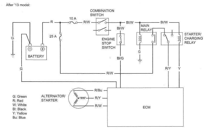

Oh forgot to mention; if the resistance is infinite between those points with key fully turned, you can still do as the SM states and get to the 4P connector to measure for continuity as they suggest if thats oke then its the wires going from there to the fuse box. Basically my route would be to eliminate anything from the system diagram as shown below, but as you already tested the fuses and relays theres nothing much else there except the ignition switch and the engine stop switch (although I do not think the engine stop switch should interfere with even the lights coming on).
