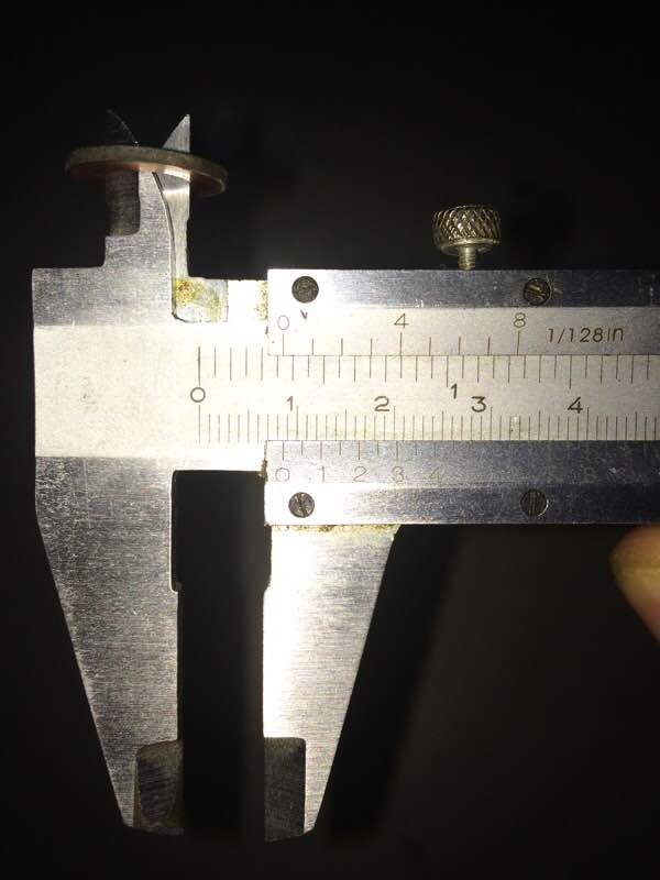

gear oil washer sizes
when i changing the gear oil i measure the washer size to be able to buy next time
drain washer 16mm diameter and 8.5 inner diameter copper 1mm
filler washer 16mm diameter and 8.5 mm same size copper 1mm
- filler plug washer inner diameter
- IMG_4738.JPG (35.29 KiB) Viewed 15957 times
- filler plug washer diameter
- IMG_4737.JPG (39.67 KiB) Viewed 15957 times
- inner diameter
- IMG_4736.JPG (32.28 KiB) Viewed 15957 times
- washer diameter size drain
- IMG_4735.JPG (31.52 KiB) Viewed 15957 times
