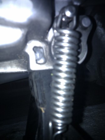

OK, a Customer just came to my Shop and I borrowed Their camera....the PCX125 has left, but here is a Pic of what my PCX150 has cast on that Our PCX125's didn't have. Not sure if Anyone else's 125s have these or not, but Ours didn't apparently. Here is the "Extra Boss" that's on both sides of my PCX150, missing from Mitzie's previous PCX125.....
Please look at Your 125s, and see if these are there or not.....THANKS...

The red part isn't on my PCX, see below...

Yep, that's what's missing on my Wife's 125.....I took that with a really bad cell phone camera, and will try to take better ones with my good camera later. That Area represents some really major extra "beefing up" of the engine case. Apparently Honda became aware of an issue and fixed it......These basically represent heavy duty "gussets" attached to the Mounting Lugs...there are also two extra "meaty" ribs cast forward of these too. The 125 had the "ribs", but thinner, shorter, smaller.....I feel better about my 150, but not so well for the 125 owners now.....
