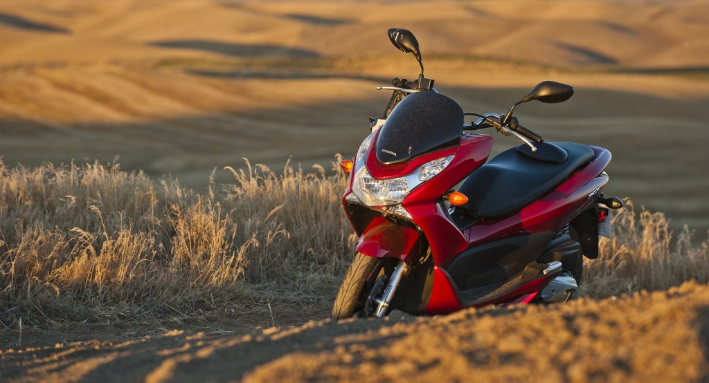

Want to find the best option for mounting a trunk to my '11 PCX125. I'm professional photographer and need a VERY secure trunk and a strong mount. Ideas and suggestions?

8) pic, you must be a pro... not so sure about the bird poo on the PCX :lol:
Re: Just joined. Need info about mounting a trunk to my PCX
Great pic. Being that you are a photographer, I hope that will be able to see more of you great PCX shots being posted.

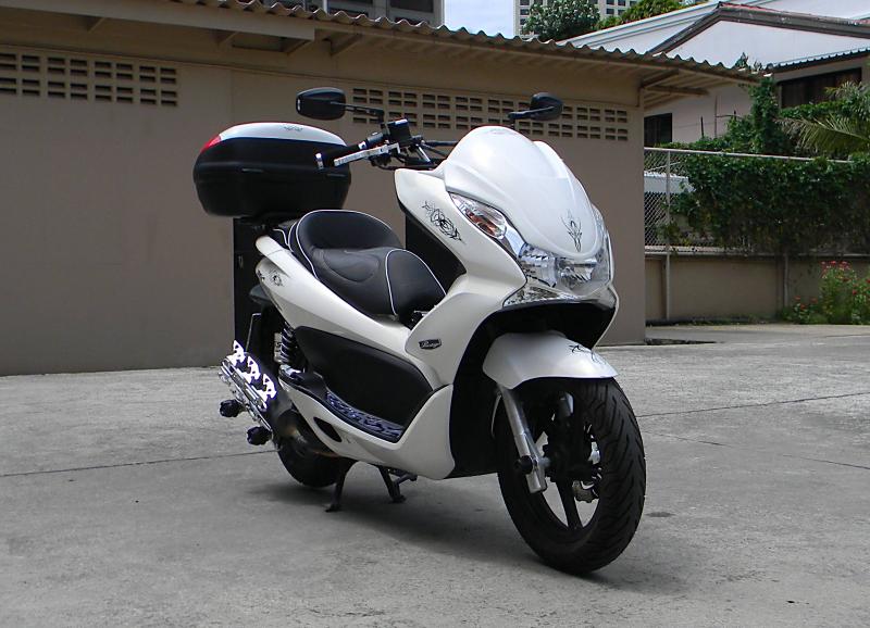

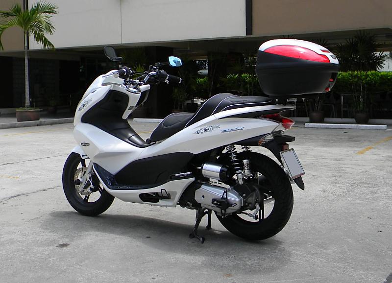

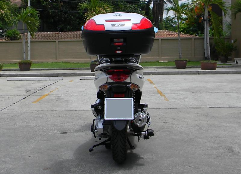

Will you be installing the box/trunk yourself, or getting someone else to? If you are doing it yourself, I have some good pictures of mine being installed at a shop. The guy let me stand there and take pictures.
Here is what the finished product looks like.
PCX 005 B_800x600.jpg (70.79 KiB) Viewed 5722 times
PCX 007 B_800x600.jpg (71.67 KiB) Viewed 5722 times
PCX 012 A_800x600.jpg (69.55 KiB) Viewed 5722 times
