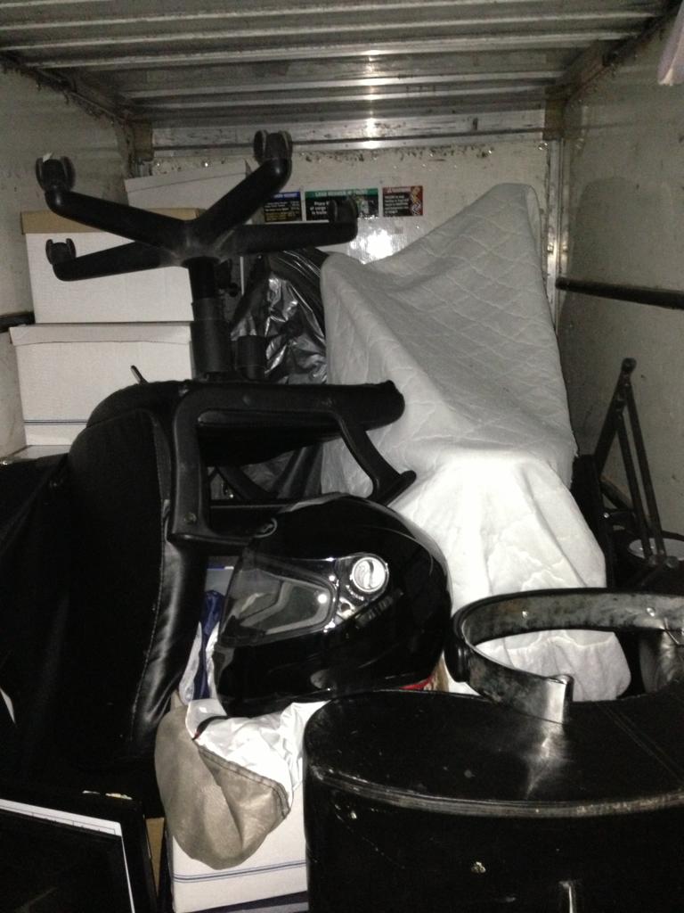

Got it in. Looks like this trailer has built in eye hooks from uhaul itself.
That's the scooter under the white fitted padded sheet. Tied from handlebars, front wheel, and back wheel no stand used

Why do I feel nervous? Looks unstable and S h a k e y to me. When are you leaving, is there time for adjustments? How far is college? Is it me folks? C'mon, a desk chair upside down hovering nearby, your hat just sitting there ready to fall away. Are those bars between the wall and bike? Are those boxes secured? Lower the piles...they are too high. Really. That's your scoot hiding under there, it needs more protection. Strap all your stuff, secure, secure, secure! Stuff old pillows, throw pillows, blankets, sheets in cubby holes in and around Your bike. Use bungie's/rope to keep things from sliding into it. You do not want slip n' slide activity going on back there while you are driving. Wish I could help ya, I've been called "The Packer" a nit picker mover. Stuff goes in and comes back out in the same condition. Not trying to bully you, just want to help and point things out. Could be that I'm too protective, sorry. You want to keep that smile on your face when you get there, don't cha? Take another look inside.
All said out of concern (o; wishing you & your scoot a safe trip!

This is my moms packing. And college is 30min away. All she would let me do is strap it down. But scoot is secure to floor eyelets. And there is a memory foam mattress pad between scoot and boxes

Hmm... :roll: ...be careful, be V e r y Careful driving (said while putting my blindfold back on again). Good luck with College!! :P

It worked. Nothing wrong.
