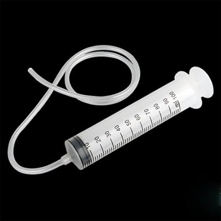

I bought one of these for changing the gear oil in my Ruckus. I just cut the tube to the length I needed.
http://www.amazon.com/gp/product/B00C37 ... UTF8&psc=1
