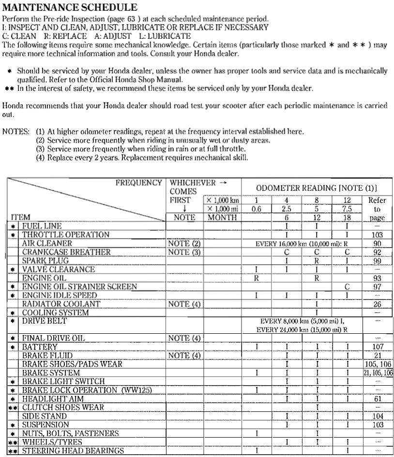

http://hondapcx.org/download/file.php?id=384 is the maintenance schedule.
If you have a good dealer that you trust, and know they'll give the bike a good once-over to check everything, I recommend having the dealer do the first service. A good dealer will make sure everything is tight, factory-lubed, and in place properly.
If your local dealer is less than competent, you can do the maintenance yourself. The two main things performed the first maintenance are the valve adjustment (how-to located here: http://hondapcx.org/viewtopic.php?f=3&t=24 ) and an oil change (how-to located here: http://hondapcx.org/viewtopic.php?f=3&t=25 ).
