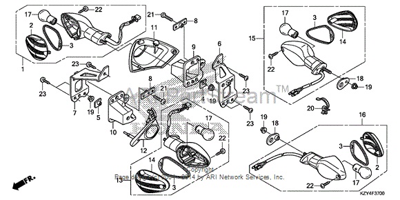

Hi and welcome! Hopefully the below pics will help
Here's a website well worth holding onto: http://www.servicehonda.com/parts/lookup. You can find this turn signal photo below at this site along with part description by number.

Thanks for the info. I have the proper part from the dealership I just don't know what to take apart to gain access to unplug and plug in the old/new signal. I'll look at the site you gave me.

The part I got directly from the dealership and matches your drawing. Not sure if the dealership could tell me over the phone or not. Hate to have them fix it as I am sure that will be a huge bill.

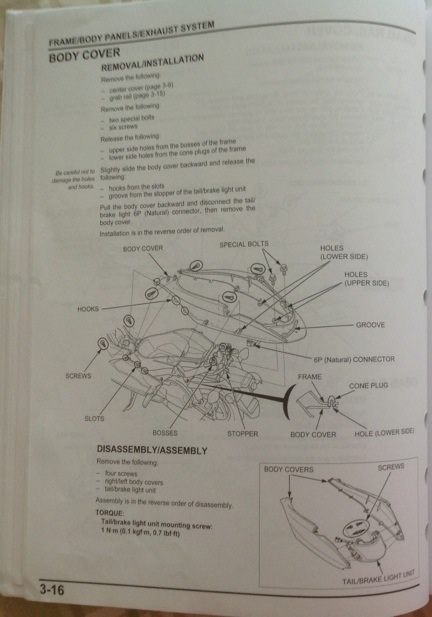

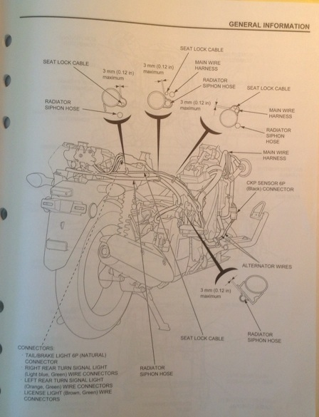

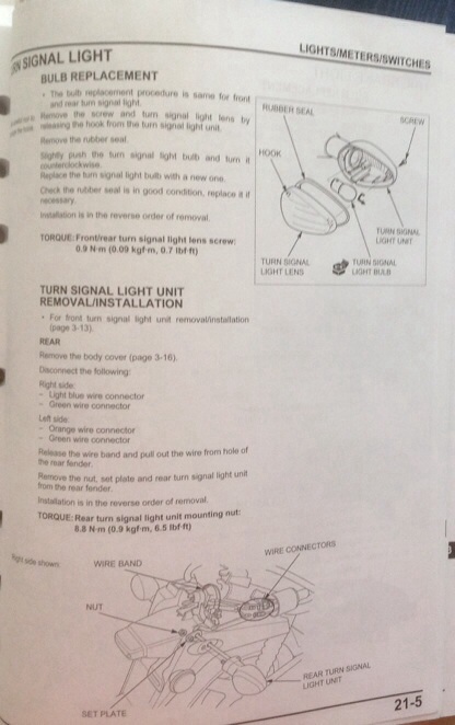

Okay, now pics from my PCX 125 Service Manual (should be same or similar to 150)
Sorry not the best quality. I did this on the fly. Good luck

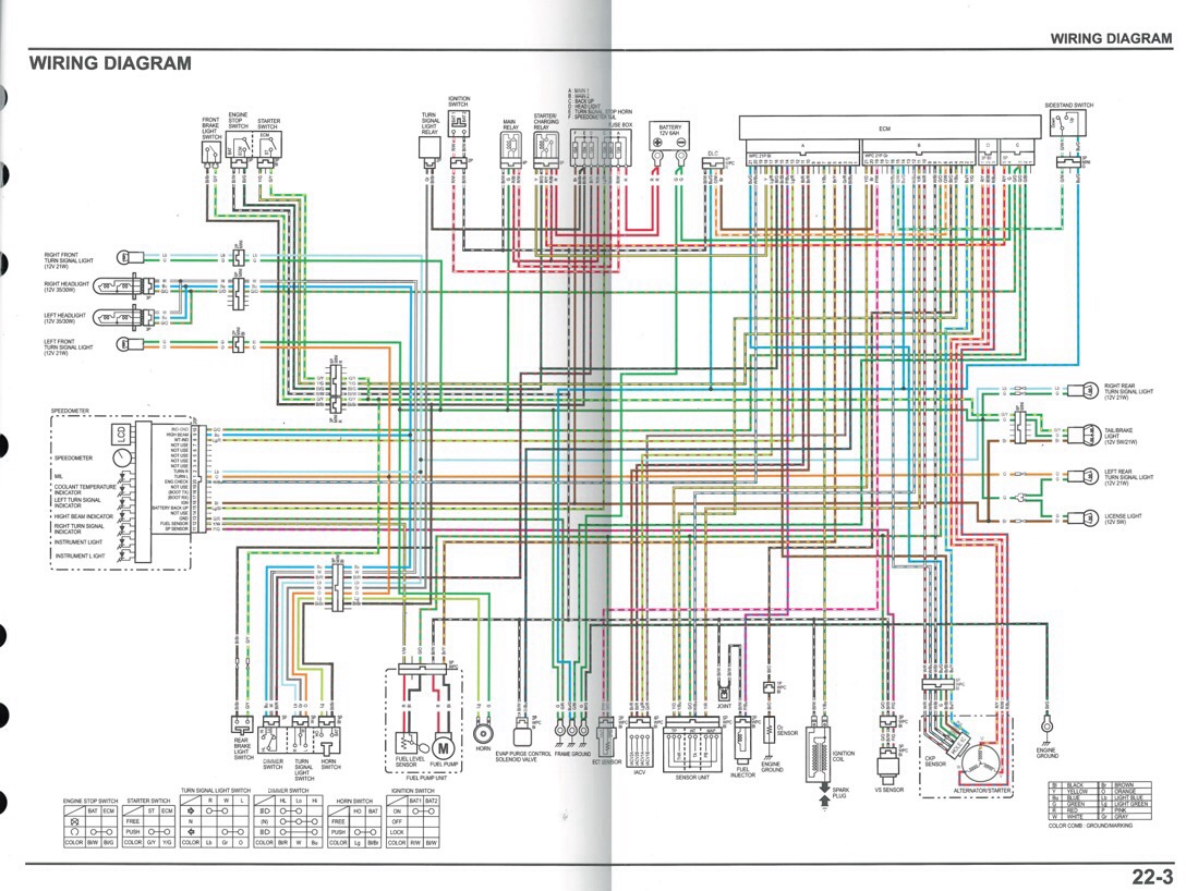

Reality pic, from PCX I had. Anything helping?

Thanks again it looks like that might help. I took cover off yesterday and looked like mine crossed in front of tail light near seat latch and went to the right. Real busy with work so probably won't try again until this weekend and will let you know how it goes. I'll try to remember to take pics.

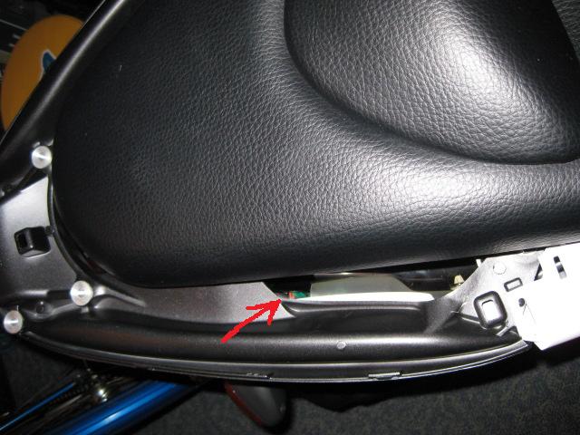

This pic is from another how-to, you can see what the harness looks like on my dirty PCX.
Note that there's some extra crap on the harness that I've installed (sloppily):
