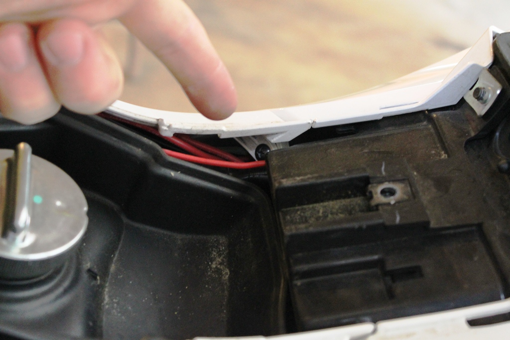

The first two screws are hidden down by the fuel cap.
Two more on either side of the seat mount.

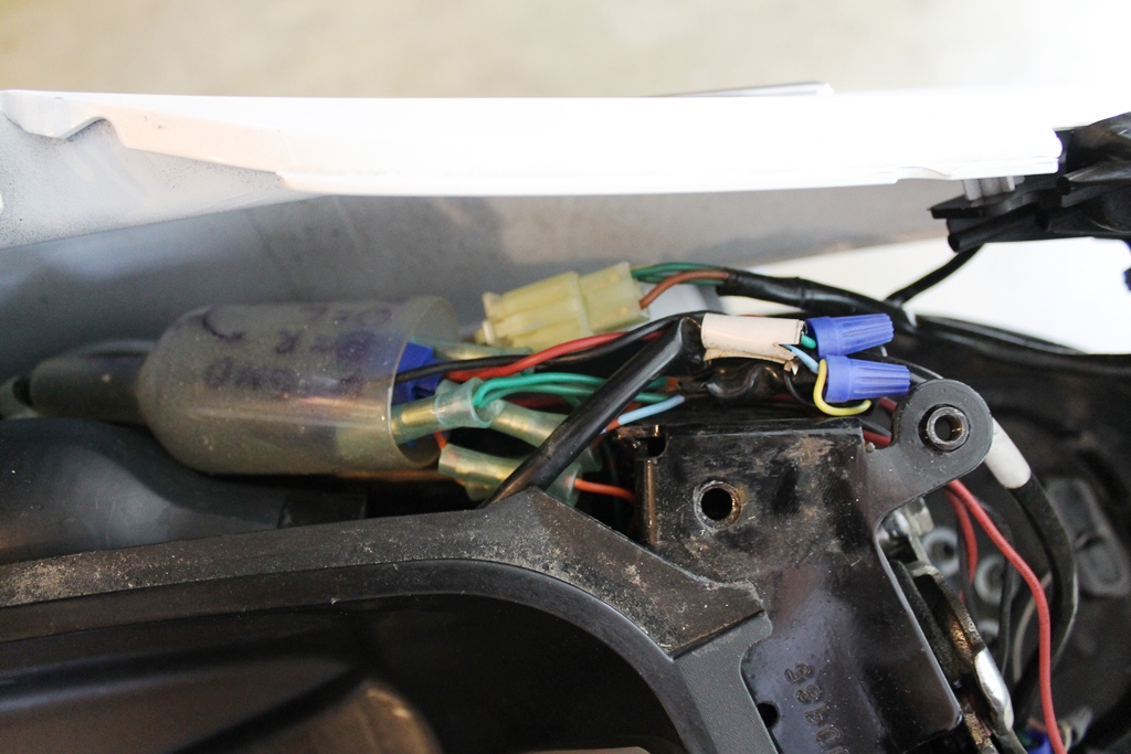

Unplug the wiring harness before yanking the taillight off. Mine's a bit of a mess from adding aftermarket blinkers, but it should be fairly straightforward -- match color to color when reassembling.

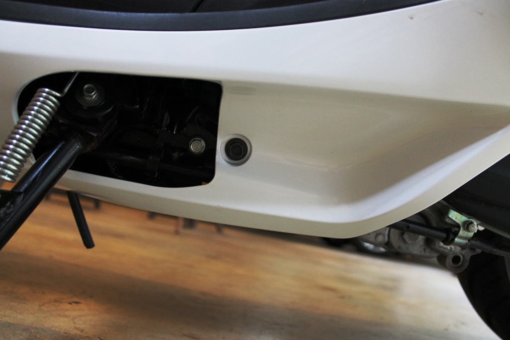

Remove the silver bolt below the passenger footpeg on each side.
And the one by the kickstand.
