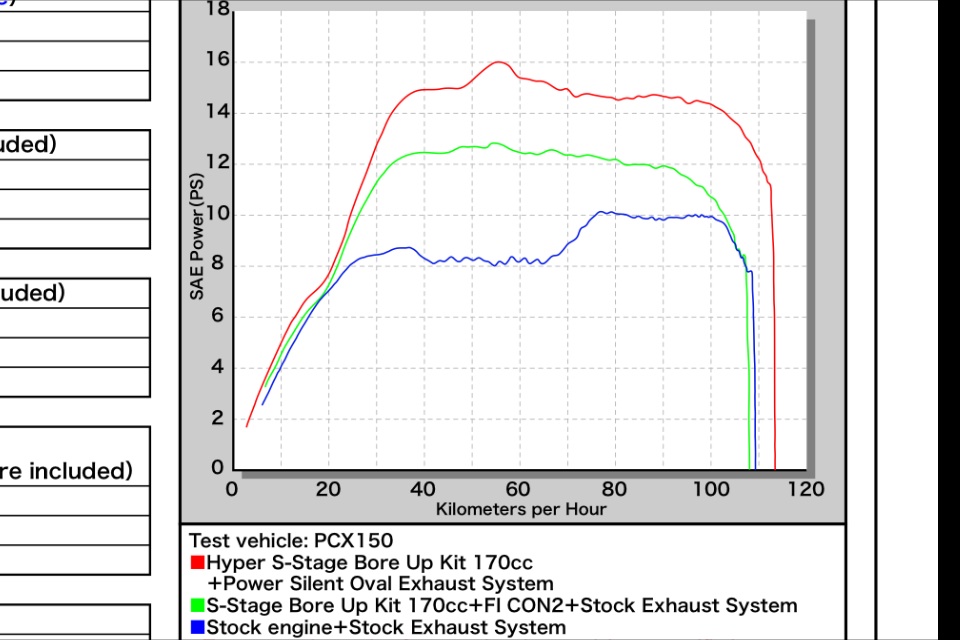

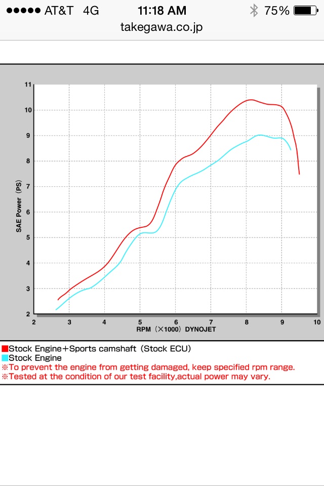

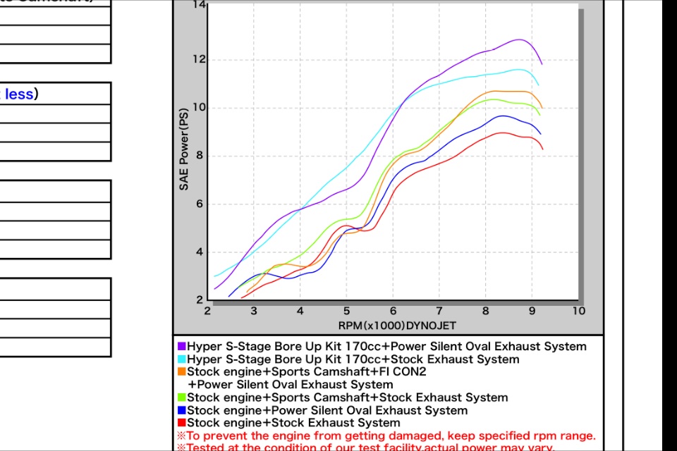

Post by Mgalutia88 »
Interesting...
Here's Takegawa's dyno map for the cam and 170cc bbk based on the 150esp.
Pcx v1 125cc camshaft on stock engine dyno chart
Pcx v1 125 cc big bore kit dyno chart
Pcx 150 170cc big bore kit dyno chart

Liking that the Power Silet Oval exhaust is showing some nice gains even on it's own. =) THe whole kit is $549 euros...what a deal! I'm tempted. But really don't feel like wrenching on the bike. Would prefer to just ride it. But it is sounding really nice. Good thing I'm reasonably light weight at 150lbs.

Finally. A proper dyno chart for the PCX with a locked variator.
