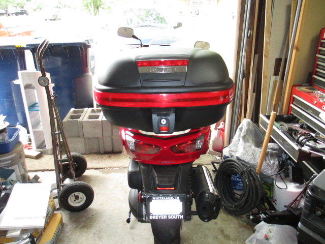

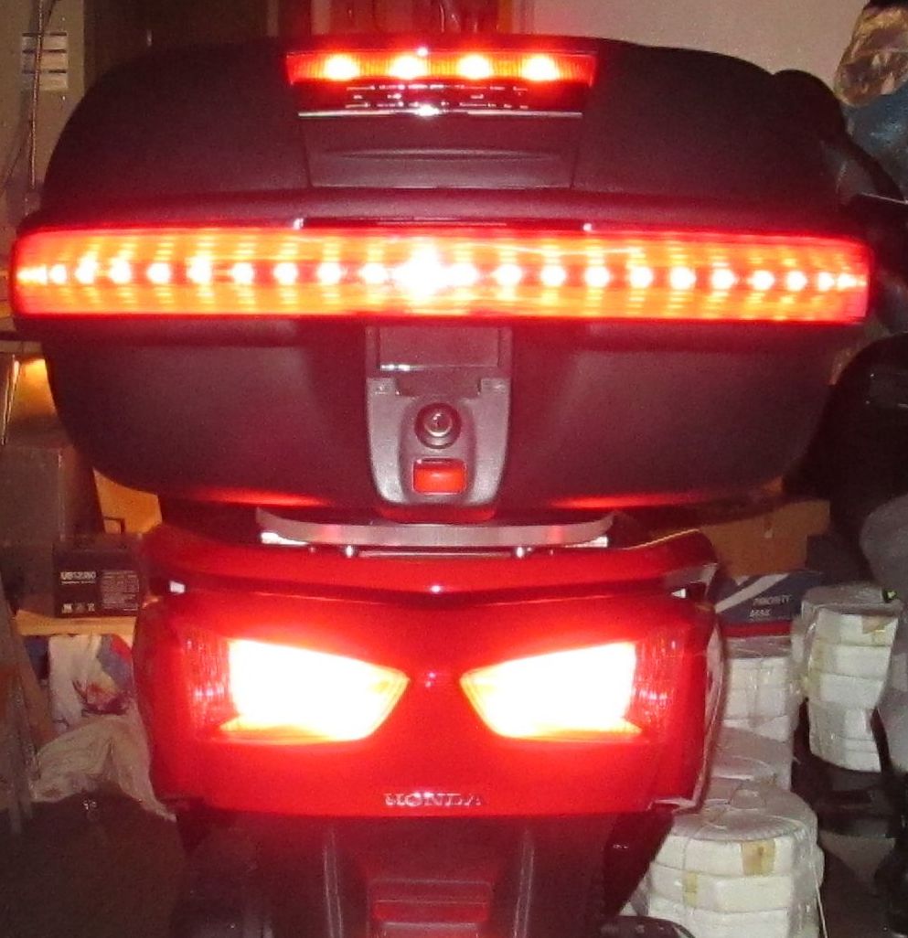

Here are some pix of it on my Kymco with the key on, key off, and brakes applied.

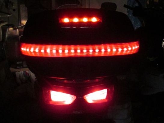

This box holds 2 full face helmets, and comes with the LED strip of running lights installed, a seperate brake light on the lid and a second series of LEDs which come on with the brakes applied.
In short, a lot of LEDs - which are very visible as running lights even in daylight, and a very bright group of lights when the brakes are applied. It is also quite visible in daylight from the sides, as the lights wrap around the box.

Brakes applied
Ignition off...

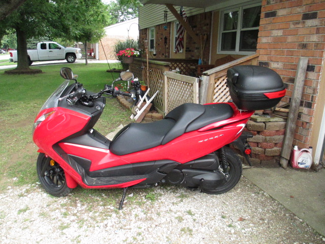

I just put a Bestem 929 on my Forza. Have not yet hooked up the lights thou. will try to post pics later

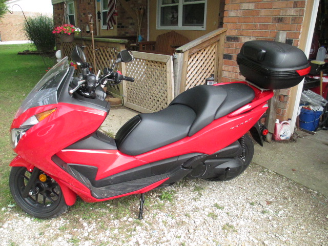

Here's my install on a Kymco LIKE200i.

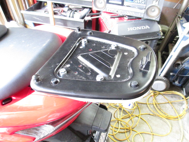

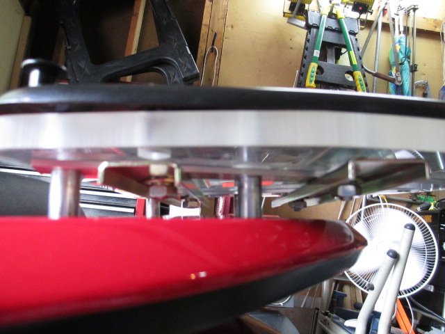

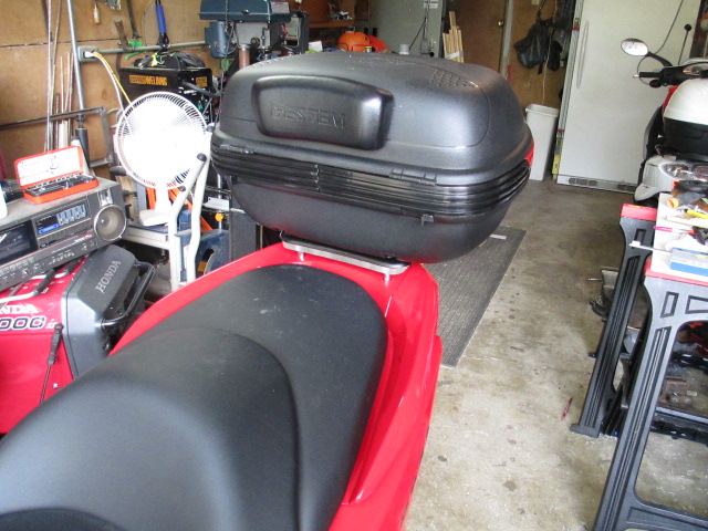

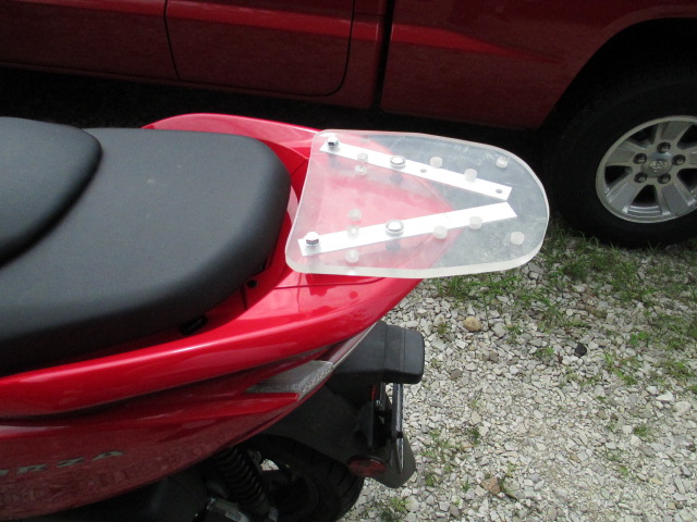

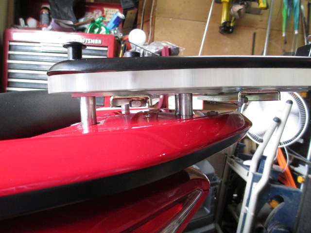

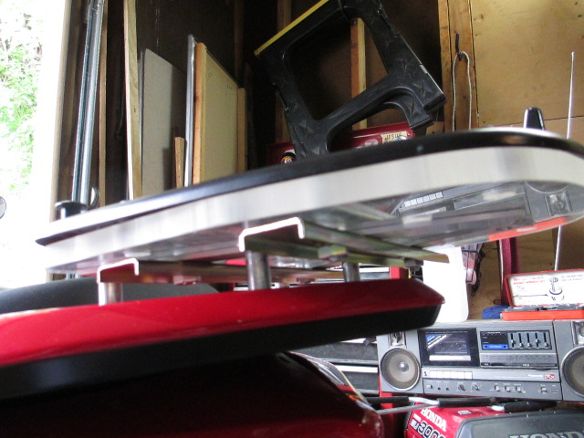

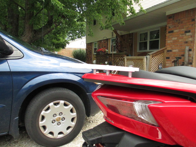

Made a carrier base using steel spaces, aluminum flat bar and some 1/2 thick plexiglass (I had laying around). Waiting for some parts to arrive before hooking up lights. Got some connectors on ebay that match the light harness in the forza plan to just make a small harness adapter inbetween the forza's harness connectors

Looks good. Nice job!
Are you going to set it up so that it is removable?
My one complaint of this Bestem 929 is that I can hear it moving a slight bit over bumps.
I have no interest in removing a top case once installed, so if I go with this Bestem on my Forza it will have a solid mounting (maybe of alum. stock) of some sort.

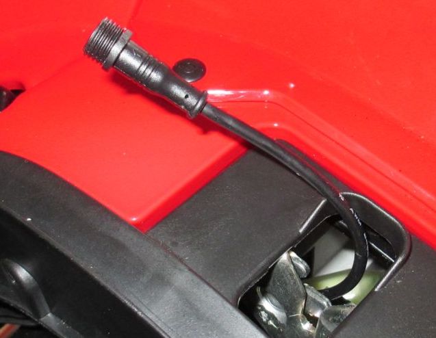

If you mean removing the black mounting plate, Probably not as getting the nut and washers on the front is a bit tricky (can hardly get finger tip between bolt and spoiler cover plate).Do you mean the box or the mounting base moving? I have not heard anything from my box going over bumps on the way to work. Does your base have all 4 rubber support bumpers installed? I have seen pics where they where not installed in the plate while mine came with them installed. Parts I'm waiting on is a waterproof connector so I can disconnect the lights when removing case. Will probably run the wire down thru the seat latch opening. Will post more pics when that part is done.

based the design of my carrier off one seen online made of hardened aluminum. seen one posted on ebay $139 but have seen some sites selling it for around $70

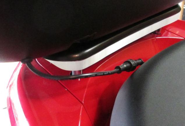

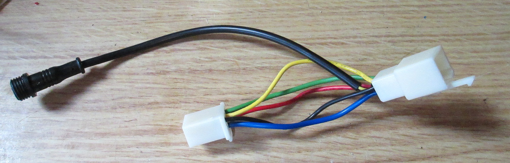

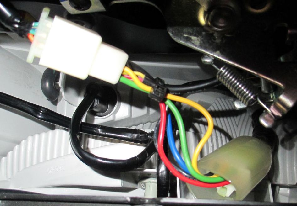

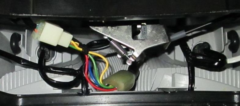

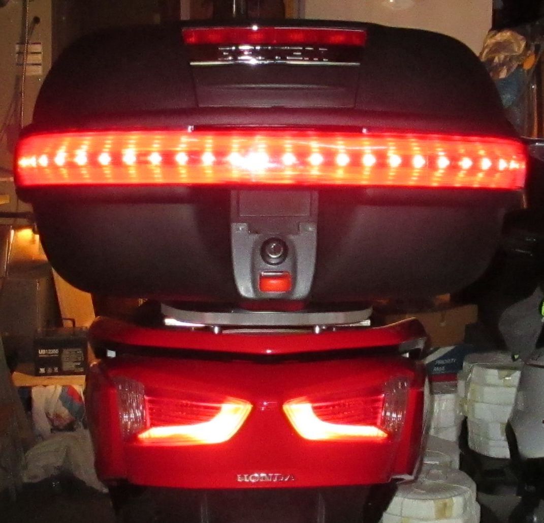

Got the lights hooked up. I installed a brake light flashing unit that I purchase along with the box on Amazon but didn't like it's performance.
Lights appeared dim and flashing was more dim to dimmer instead off on off and when it stopped flashing to stay on solid it would be at the dimmest point.
as you can see in the pictures I made a Harness adapter so I wouldn't have to splice into any wires.

That is a SUPERB job of wiring your Bestem top case.
Really, very well done!
If I was going to put one of these on my Forza I might try to commission you to make me a no-splice wiring harness like this! (at my age I can just barely mount this scooter by swinging on like a bike.....and any top case back there would compound the problem for my long legs!)
Any tips on where you found the parts used here?
Great job....thanks for posting!

Just ordered a Bestem 929 box to replace the smaller box I have on my Forza. I ordered the wiring harness with it. Just wondering how well these boxes are holding up? The lights look great.
Re: Bestem or LEDs on the rear?
Couple of years on. ..and mine is used every night.
If it ever quits I'd buy another...BEST safety feature for night riding. ..at a fraction of the other lighted top cases.

I love the wiring harness adapter you did. That is very professional looking. I am concerned that you couldn't get brake light flashing unit to work correctly. It could be the unit itself, or several other things. That is why I purchased the Knight Riderz unit from CustomDynamics. It is a reputable site with good quality items. With all of the LED lights that I have added I did worry that it might not work correctly, but it did.
I would have loved to make an adapter harness like you did instead of soldering into a splice in the original wires, but I didn't know where to purchase the connectors and pins that match Honda's.

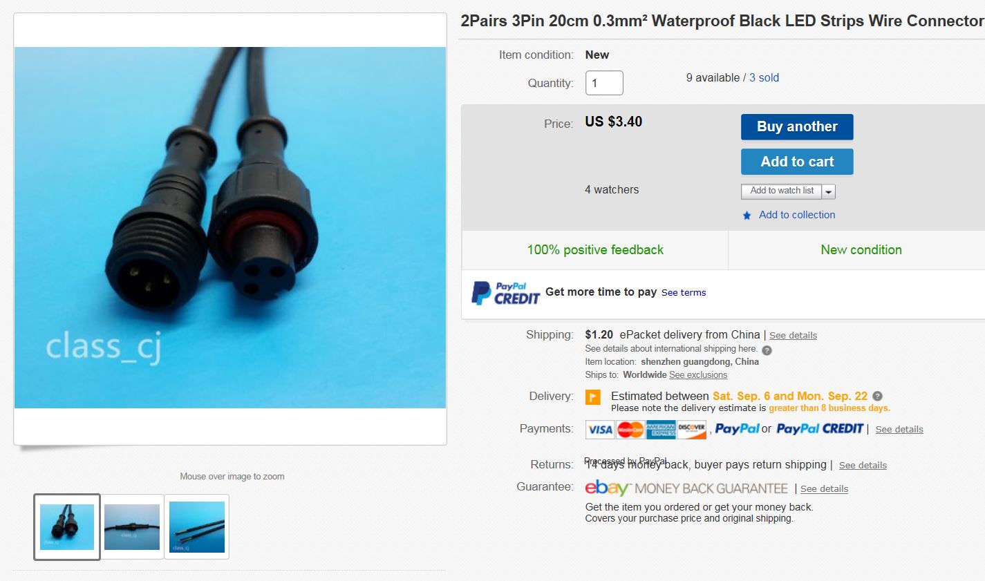

Cycle Terminal - OEM Japanese Wiring Terminals, Connectors,Kits and Supplies
http://www.cycleterminal.com/index.html
