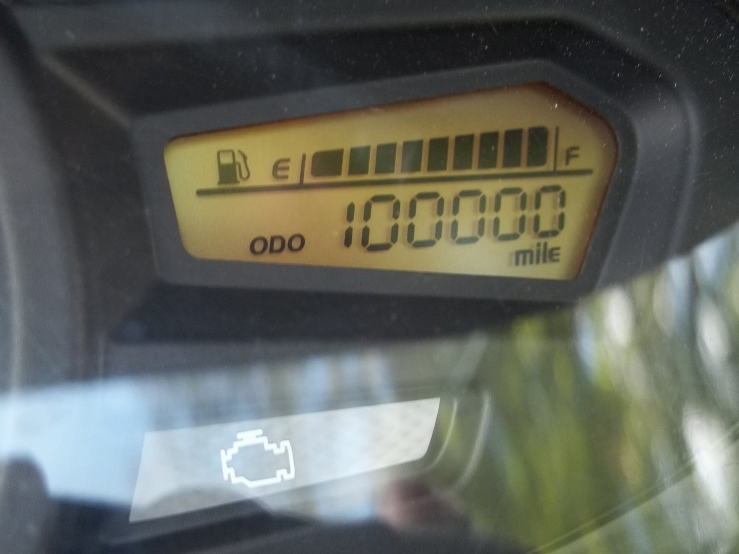

Well Guys, Old Faithful made to 100k. [Had 2,092 miles at purchase] Still running fine. Over the years, have had around 2 dozen Motorcycles, and
enjoyed each one, but the PCX is my favorite. Have a Forza too......fine scooter, but the PCX gets the miles. Honda got it right. Except for the valve
check interval. : )
