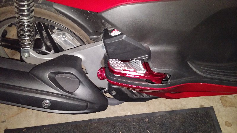

Still waiting for a compfy seat and the red anodized brake levers. The wife just doesn't understand the value of these. :lol:

Any one know how to change the foot rests?

Will do. The rests are gorgeous. Shipping was 15 Euros for the box (about $19.24 USD) Sure arrived quickly.

Only a pin with a cotter key on the bottom holds on the rear foot rests. ;)

When you remove the old foot rests be careful because there is a spring and a ball bearing in the rest that snaps the rest in place out or in so the bearing doesn't roll away. They have designed the bottom plate a little larger so you can hold the spring and ball in place as you put the new foot rest in place. It took a few tries to get it.

Installation was nice. Had to take a deer looking ride first before dark. They sure look better than the cast aluminum ones like the rear rests. The seat is the last thing left when it arrives.
