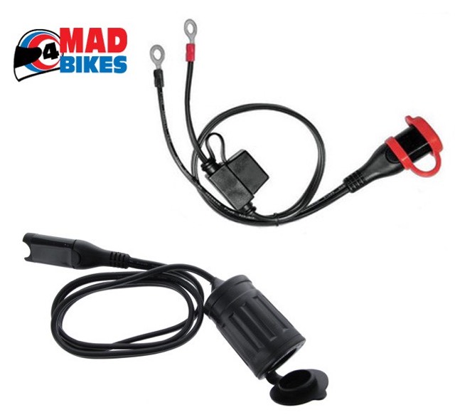

If your going to wire it a more reliable connection would be to use ring terminals onto the battery terminals instead of crock clips. You'll get your battery cover closed as well.
See the photo for an example of what I mean.
If your going to disconnect the battery it's negative off first, then connect the positive then negative on last. It'll stop you shorting anything.

- ImageUploadedByTapatalkHD1426185999.176575.jpg (44.49 KiB) Viewed 2190 times

You can use the same socket if you wanted. You can get crimp on connectors from car accessory shops. You just need to make sure they are fitted correctly with a pair of crimping pliers.
Re: Fitting a 12V charger adapter and LED night lights...
I bought an adapter that has a water proof cover and i installed mine close to where the gas cap cover is, just to the left and up some. It fit nicely there. Under the seat works nicely also, especially if you buy a battery tender and leave its connectors attached to the battery. Then you can plug the adapter into those leads. The 2nd picture may be one of thosethat plugs in like that.
