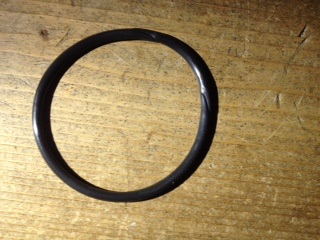

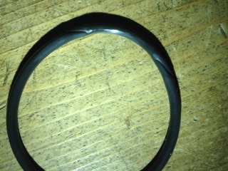

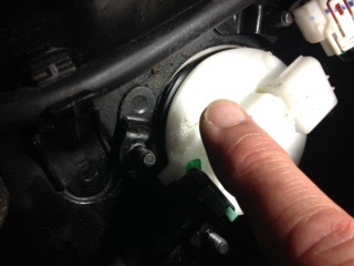

UPDATE FROM THE FIRST POSTING,ok I took the scooter apart to see what the dealer did wrong causing this massive fuel leak after the fuel pump recall , this leak is caused by the o ring not installed properly as seen in the picture ,the other two pictures are of the same O ring on the work bench but different views and lighting and it's clear part of the o ring was pinched when installed. So now it's 100% clear on what's going on with all these fuel leaks after fuel pump recall!

- Different view of damaged fuel pump o ring
- image.jpg (37.15 KiB) Viewed 8842 times
- Damaged Fuel pump o ring
- image.jpg (34.51 KiB) Viewed 8842 times
- View of fuel pump still in tank with o ring popping out . Note o ring is under ,dust seal
- image.jpg (19.95 KiB) Viewed 8842 times

Re: Honda forza 300 fuel pump recall leaks gas after recall
Forza300 Don, Well done!
Very helpful post, & with pictures of the problem!
I simply find it hard to believe that Honda is trying to use an 0-ring that is not compatible with gasoline.
Frankly I do not buy that - I think the pump/0-ring/dust protector ensemble just needs a bit of care when it is slipped into place.
Perhaps it is a tight fit....and a too soft ring might make this an struggle?
That partially squashed 0 ring looks pinched - not swelled.

I think most techs are just installing pump and o ring dry and once on its hard to see if the o ring is in proper position due to the dust seal ,hiding the o ring under it , I will find out soon as I get my parts I'm waiting for a new o ring and dust seal from the dealer that did my fuel pump recall, I'm also thinking of contacting honda Canada in there tech line assistance to let them know what's going on , (they maybe already know ) I did work with them on many other issues on the car side for over twenty years, in Canada I would be surprised if there were one hundred Forzas sold last year in canada so our country would not be on a priority list compared to Italy or other countries that sell more scooters, I did take a lot more pictures and documented more of this problem if needed.

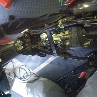

Since we all like pictures here's what the forza looks like disabled to perform this recall. Sorry for the dark picture
Don
Don
- View of forza disabled for access to fuel pump
- image.jpg (24.7 KiB) Viewed 8820 times

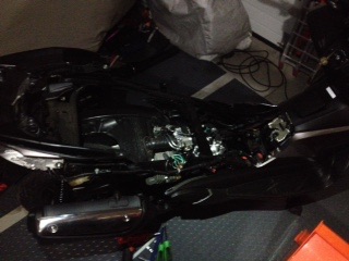

Here is a clearer picture of forza disassembled for fuel pump removal
- Top view of forza
- image.jpg (42.5 KiB) Viewed 8816 times

The techs if installing the o ring properly and coating the o ring with a film of oil ,what they might be doing wrong is ,once they push the pump down they must keep downward pressure or the o ring will come out of place , but in my case the o ring never was in place because there was a section of the o ring that was clearly outside ( pinched) from either no oil put on the o ring or when pushing the pump in they were not pushing it down evenly into the hole causing one side of the o ring to come off and then getting pinched outside and the tech can't really see properly with the dust seal hiding the o ring under it . Unless they really inspect it properly, I'm thinking before I get my new fuel pump o ring I maybe will try installing the old o ring without the dust seal and see how well it seats , my old o ring a day later after removing it ,is now starting to look like a new o ring it's regaining its original shape and is now hard to see were it was pinched. It's not going to hurt anything to give it a try! The bike is all apart and I'm going to put a new o ring anyway! The old o ring maybe is stretched as when I remouved it it was a bit loose on were it was supose to fit on the pump . I will keep this post updated. Oh and if anybody has a copy of the procedure from honda on the recall it would be nice to post it ,because when the dealer did the recall on mine they remouve two screws under the fuel filler door and left them out , I don't know why because they don't have to remouve anything at the top of the gas tank ,it's all under the seat storage box! Maybe the tech. Didn't know what he was doing!

Ok I just got back in from working on the scooter I decided to reuse the o ring that was pinched by the dealer when they did the fuel pump recall,there's no way I'm waiting a couple of months or more for honda to get new o rings or they can have this scooter back I bought it to drive not sit in the garage in a million pieces, so after two days the o ring reshaped itself and there were no nicks in it here is how I got it fixed , the fuel pump must be sitting perfectly straight on the tank with the o ring sitting even all the way around the fuel tank tapered hole , there is no room for error , I lubed the o ring with dish soap ( one drop ) and spread even all around then lubed the tank taper with the film left on my finger I then remouved the dust seal and put the pump in the hole I did this so I could see that the o ring was sitting even all the way around the tank opening I then held it lightly in place and then put the pump hold down brackets on and tightened the nuts a little at a time in a crisscross patern this is very important because if you tighten one nut too much the pump will be pulled in too much on one side and cause the o ring to pop out , once all nuts tightened down I then backed them all off and remouved the pump brackets,(but don't pull the pump out)I did this to get a look at the o ring to see if it's in properly , IT IS.. Ok now I need to put the dust seal on , i lubed the dust seal with dish soap then started to push it on while the pump is still in tank I know this is not the way to do it but there's no way I'm taking the pump out risking to get the o ring out of place, this can be done , I carefuly worked the dust seal on ,it's diffecult du to the pump tabs but I got it with the help of a small pick tool , filled the tank and NO LEAKS , I will wait until the morning to make sure there are no leaks , then I will put all the body panels on , I think honda can fix this problem by making a longer and wider taper on the fuel tank ,so it would be less critical to have pump perfectly straight in the hole.
