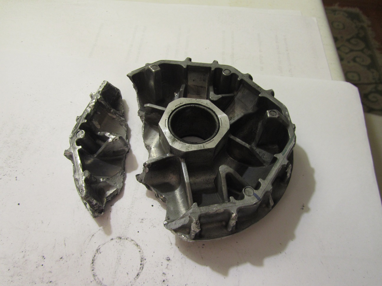

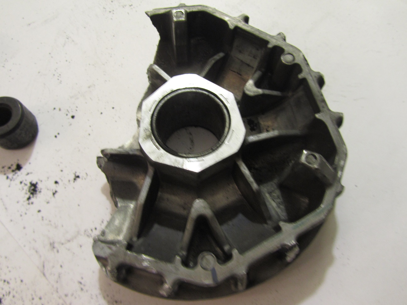

Here´s a couple of pics of the variator plate...
Thanks for your help anyway. Problem solved. The crankshaft is repairing and the crank case has been filled up with aluminium again. by the middle of the week i´ll have the crankshaft and on next weekend will be rolling again :)
Re: Honda PCX 125 Crankshaft
Flipping heck!
Have you been revving it at a standstill with the back wheel in contact with the ground?

And you haven't seen the crank... Or the crankcase Lol
Anyway... I spoke to a honda mechanic who had almost the same problem... A twisted crank. It's shitty material. It's not built to last long. And it's not that cheap regarding maintenace. The tires wear out fast as hell considering we're talking about a 125... (i drive about 6000/7000 kms until the wire mesh starts to appear) for my experience with pcx, i'm selling it and going back to the 600. Much much more reliable. Anyway for short trips it's perfect, other use besides that, the result is this
That's simply insane. I can't imagine what happened to cause that.
I have no idea what you did, but it had to be REALLY stupid or involve WAY over-torquing that variator to cause that.
Post by sendler2112 »
pedroumbelino wrote:the result is this
You are the only one to have any problem like that with the variator. And my first rear tire made it to 14,000km and the front is still on at 28,000km.
