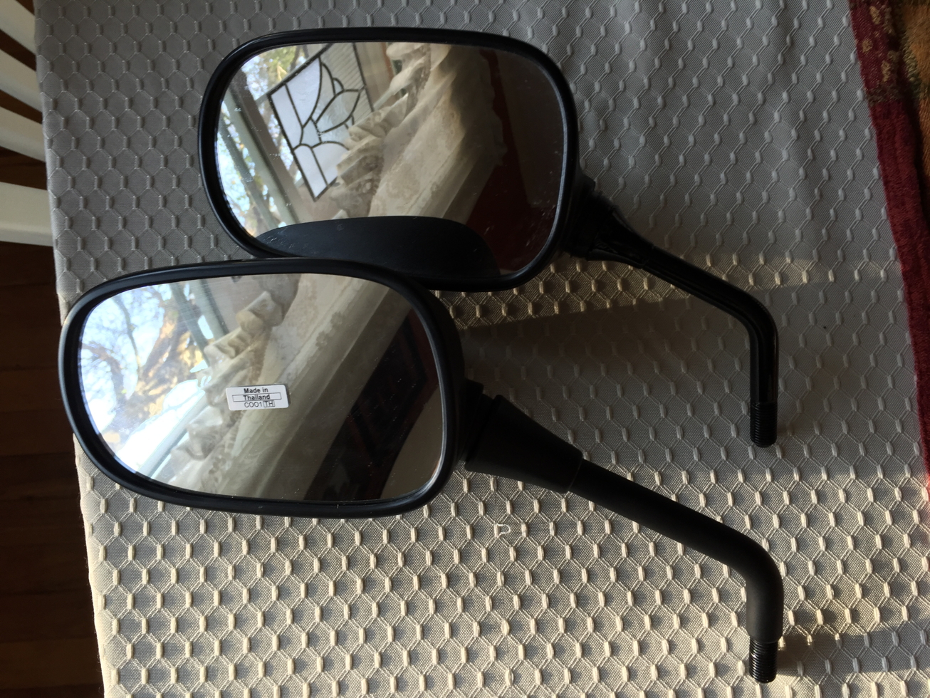

I replaced the Forza mirrors with OEM Honda CB500X mirrors....which look exactly like the Forza mirrors but with effectively longer stems. Results look stock/OEM. Honda shoulda' used them on the Forza !!

Here is a side-by-side of the stock Forza 300 mirror (top) and the stock CB500X mirror (bottom). It was a very easy swap, but not free (as sliding the hand control units would be).

CBX mirrors give much better view.

I like those mirrors though... Do you have a photo of the back (non-mirror) side?

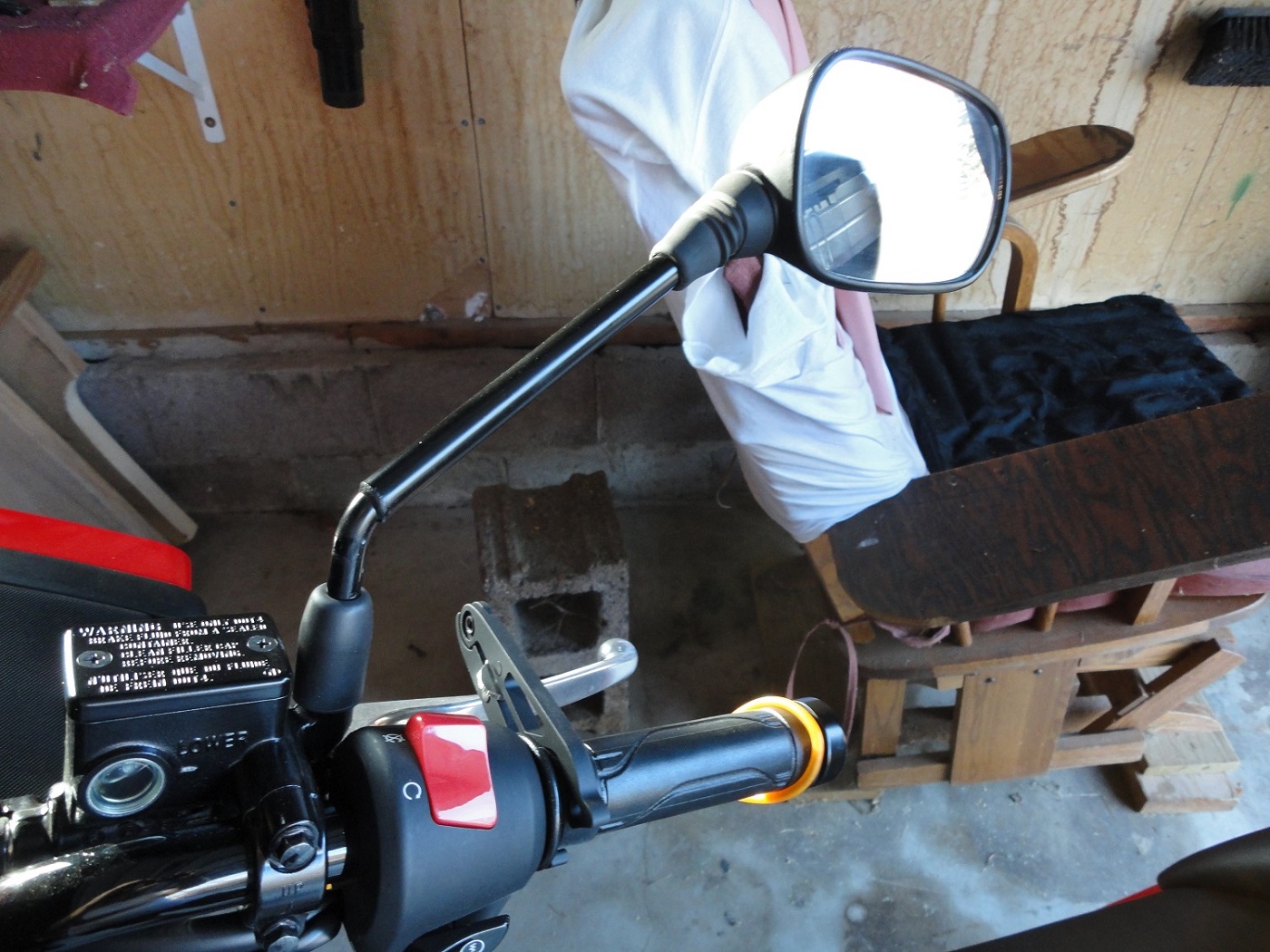

Or you can just cut the OD 3/8" pipe and add a 6" 3/8 ID pipe like I did. I also painted it black so it looks factory.
- DSC01342.JPG (416.15 KiB) Viewed 7208 times
Re: get more rear view in mirrors
That is a good idea
