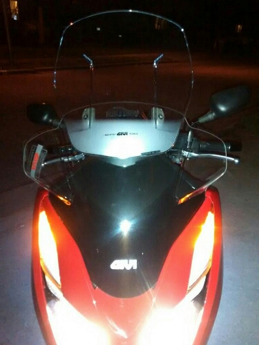

I have the same windshield... I LOVE IT!!

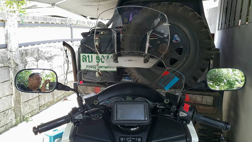

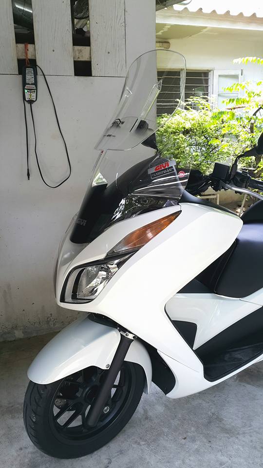

Mounted the Airflow screen today and test drove it, what a difference!! it's like I have a other scooter, so relaxt now :)

mee too, my GiVi AF1123
