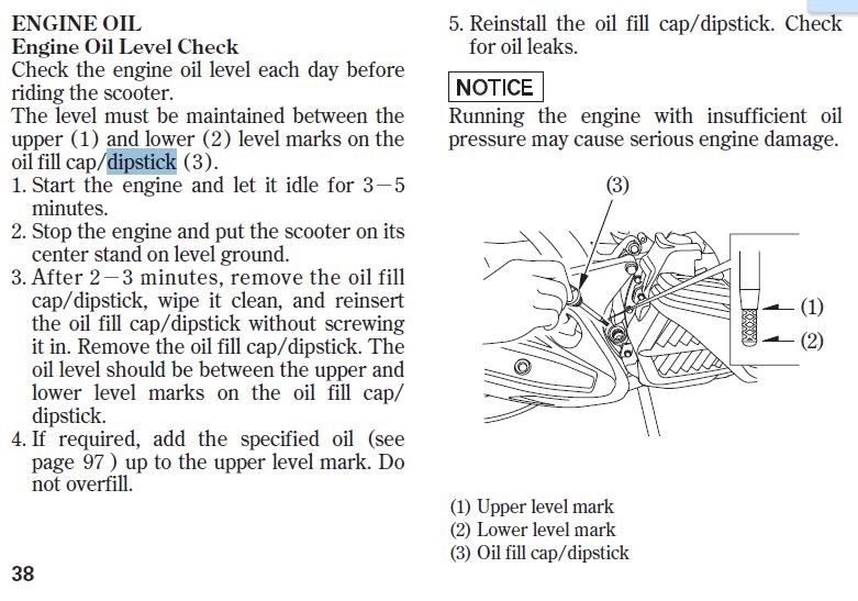

Re: Coolant low after 300 miles?
Ain't that oil dipstick a treat? There's a Honda procedure to this madness. 2015 user manual (the one we get with scoot) says to check yer oil this way vv (I do it, it works ;) )

Yeah WhiteNoise - a real pain. Idle for 3-5 mins, let it cool for 2-3 mins, remove and check the tiddly well recessed dipstick - repeat every day. No thanks - I'll check it from cold every month or so and make sure oil is on the notched part after cleaning and checking a few times. If I have no leak at home or parked in the same place at work - should be good enough.
