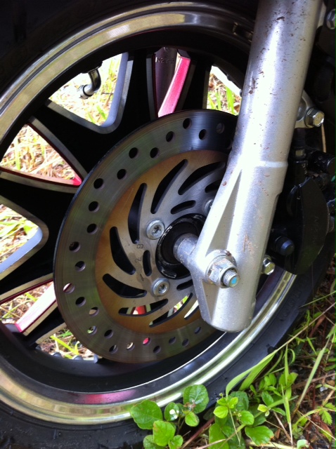

Re: Front Brake Failure - Temporary
Here's the front disk and the result of being overheated. I had no further issues with the brakes but I'm not completely comfortable without a bit of maintenance on the overall brake system.
I did a little research and this section of road is infamous for causing brake problems. I was near the top of Doi Angkhang and the problems started as I passed the security checkpoint on Thai Road 1249 headed towards Fang.
