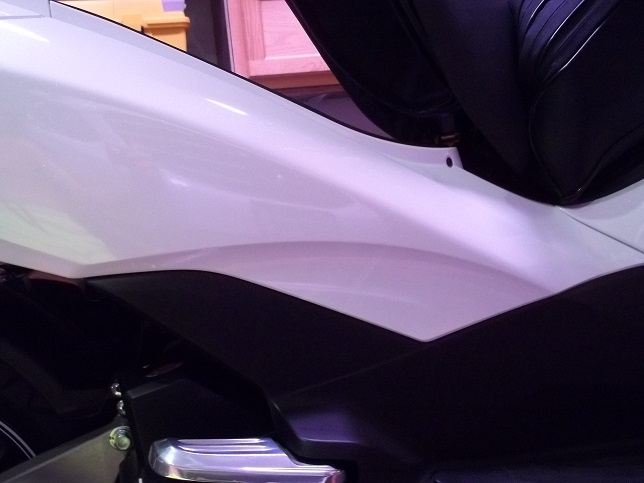

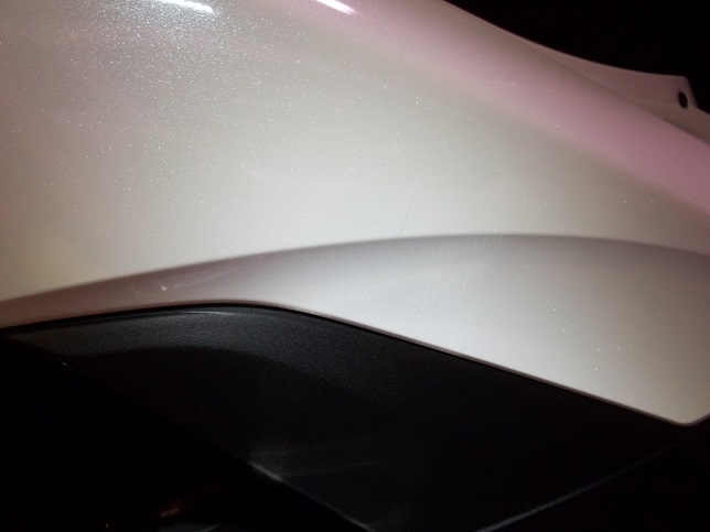

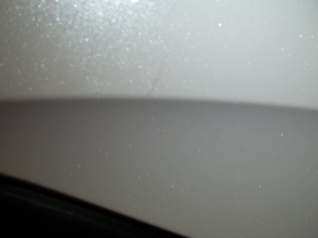

Re: Plastic Parts / Poor Suspension
You shouldn't look for stress cracks in this area. They pose no safety or mechanical issue but you probably shouldn't look because I suspect there will be many who find them. Not sure what I will do about this, maybe replace it this winter during tear down reinforcing the inside area with a coat of marine epoxy knowing it will happen again if I don't.
- 100_2717.JPG (135.31 KiB) Viewed 2914 times
- 100_2715.JPG (119.77 KiB) Viewed 2914 times
- 100_2716.JPG (94.12 KiB) Viewed 2914 times
