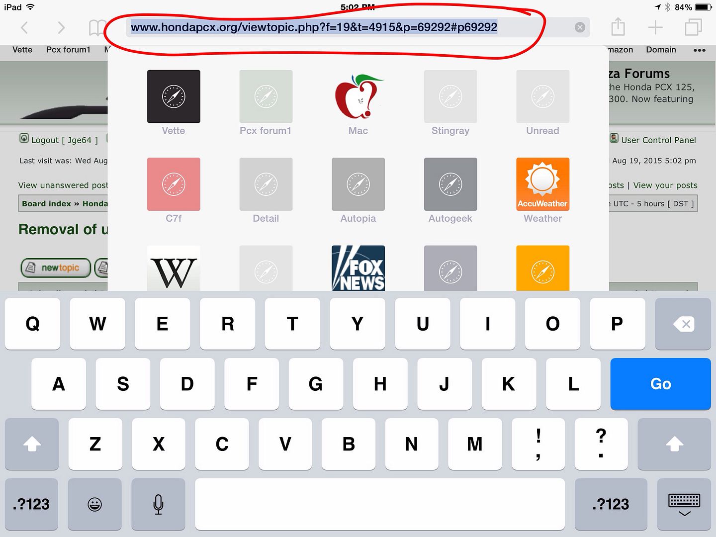

http://www.hondapcx.org/viewtopic.php?f ... it=coolantdantheman wrote:Minister, check my post on the thread "Coolant for PCX125" a little padding probably wouldn't hurt anyway.
open page you want to direct to, copy the browser text block address, paste into your post

No, copy the address that is in your browser at the utmost top of your screen. Ill shoot a pic...on my ipad its here:dantheman wrote:Thanks, homie. Copy/paste.....I may have done that before with email.
