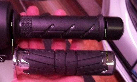

Would it be safe to say that these grips are never going to fit on PCX?
JoJo, I have seen you change grips more than once and I don't think we have a match here. Any thoughts from experience would be appreciated.

homie wrote:Would it be safe to say that these grips are never going to fit on PCX?
If they are closed end grips they should be fine.

Nope open ends, and they do look awfulyou you wrote:If they are closed end grips they should be fine.

I believe there is a fair amount of skill and effort to removing and re-installing grips, not that WN couldn't do it but these are inexpensive and probably going to the trash.you you wrote: Send them to Whitenoise. I'll say they look great
I was hoping to lure JoJo into a block of instruction on the matter. These were purchased a year ago and I still don't know or haven't seen anyone demonstrate swapping out grips. Until then I'm not ready to break down the factory glue on the PCX stock grips just yet. Not something you want to deal with if you don't know what you are doing.

It's not a difficult job other than removing the ribbing on the throttle tube. Stanley knife and a bit of patience sorts it

It doesn't really warrant a how to...
Remove the bar ends.
Cut off the old grips
Trim the throttle tube of the little ridges with a Stanley knife
Pop the new grips on (using a bit of washing up liquid if you are puny)
Refit the bar ends
That's it.
