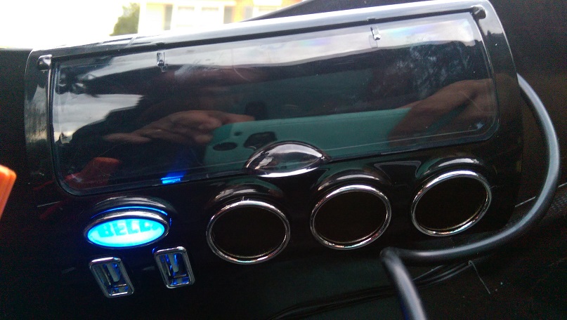

Re: cigarette lighter plug
Yes. Use an inline fuse. I got this on clearance for $8 at K-mart. It's a five plug requiring a 5 amp fuse. Works great. It came with a lighter plug which I snipped off, then attached the wires in to the battery. Be careful to use connectors that don't require you to unscrew the nuts on the battery the whole way. But yeah, I used mine the whole way from Pennsylvania to Massachusetts and back again.Works fantastic.
