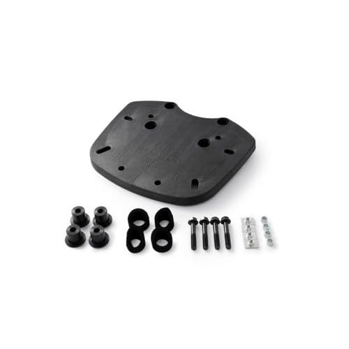

Honda rear rack and a Honda rebadged Givi topbox on a PCX 150 in Trat:
This rack is mostly plastic.

The Honda box and convertor plate are Givi but there are major differences in the Honda/Givi rear rack and how it mounts to the frame.
The Honda one is much neater but here in the UK, hugely more expensive.
Honda bolts direct:
Givi has these ugly brackets:
Honda bolts direct:

There must be at least three different rear racks available. One is from Kivi (with the "ugly brackets"). Honda has a plastic rack that needs an adapter plate (from Kivi; as seen in my post above), and an all metal one that mounts Honda's own topbox directly (no adapter needed). I guess the latter is the same as on the SH line of scooters (such as the SH300).

Yeah, pretty confusing from Honda. The plastic one they used on the PCX 125 is not nearly as sturdy as the new one for the 150. The box is crazy expensive, though much improved from the old one. I stuck with a combination of the Givi E370 box with the new Honda mount, which is very clean and sturdy. I listed the part number on my Trunk How To, if anyone is interested.khaosaming wrote:There must be at least three different rear racks available. One is from Kivi (with the "ugly brackets"). Honda has a plastic rack that needs an adapter plate (from Kivi; as seen in my post above), and an all metal one that mounts Honda's own topbox directly (no adapter needed). I guess the latter is the same as on the SH line of scooters (such as the SH300).

I've seen Givi plastic plates almost identical to the Honda OEM one GN2 posted too. It's all over the board.
For what it's worth, the flimsy plastic construction of ALL of them is why the load limit for a topbox is so small. If the mounting options were like Taz's rack, you could easily put 2 or 3 times that weight on there.
