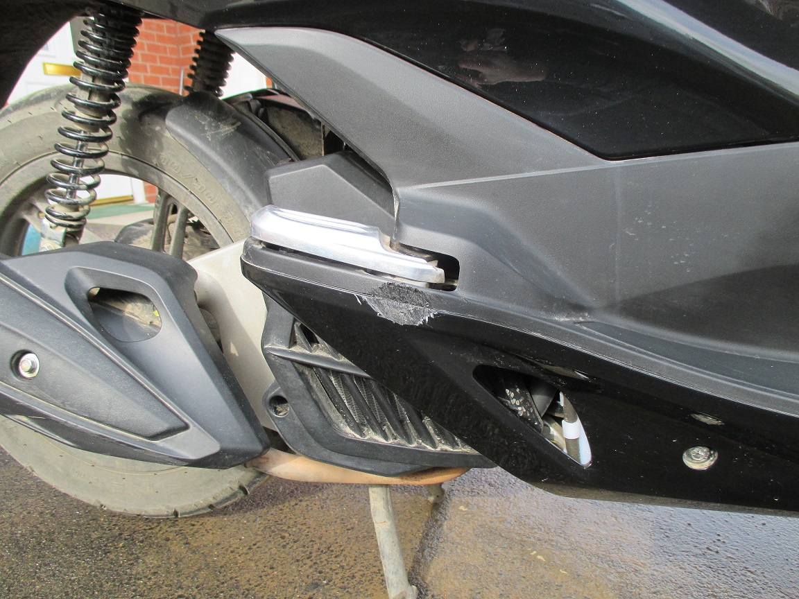

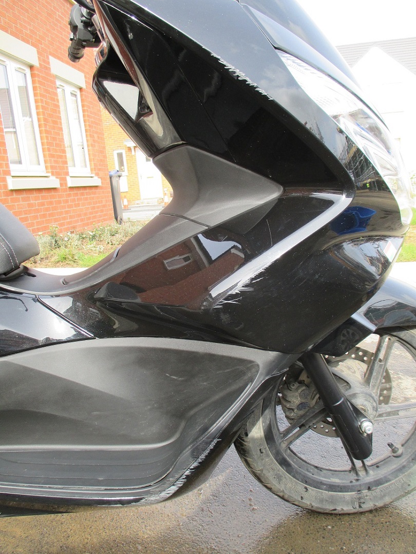

Hello Everyone,
I'm new to pretty much everything and for this forum too.
I'm riding bike in UK from 10th of January and i had my 2015 PCX 125 from 8th of February.
Today morning was the very first time to drop it. Basically road was slippery due minus degrees overnight, and this car came with 20 MPH towards me in a turn (on a single vehicle road), as soon as i've seen her (i was going with 15) i pulled both breaks which was a mistake, and dropped the sweet PCX. Cars were parking on my right side so i couldn't see the oncoming car. I dropped this side.
Not too much damage thank's god, but i will need to replace the right hand side lower middle (under footrest) panel because it's not just scratched but cracked aswell. The front upper panel near the lights didn't suffer too much damage, and this is the main reason of my writing here that:
What would you do with it, how would you repair it?
I was thinking of sandpapering it down with a soft one, and then just spraypaint it with the color NHA84.
Also, will i lose the rest of the warranty if i paint & replace panels on the bike?
I did not contact my insurance because it's a fixable scratch, i didn't crash into the car and the bike after a big inspection looks totally fine.
I aslo attached photos, please study them before writing an answer.
Cheers chaps,
Ben
Rear area with single visible damage.
Front half with three areas of visible damage.

if long waiting times is not a problem, you could order the plastic parts from one of the dealers directly in Thailand (like powerbypcx or bikerbitz). Including shipping costs the whole set of plastic parts for a PCX is around 250 Euros I guess.

If you are experienced with taking these types of bikes apart you could do it yourself, but know that there are slots, screws, and bolts that hold these parts on. It doesn't take much to break them permanently. On the black bikes, like yours, I would consider lightly sanding the edges and painting them with touchup paint or fingernail paint. Ride like that for awhile and save your money. The bottom panel is easy to replace. The one that is by your knees is one of the most difficult. It will require that you take most of the bike panels off to get to it. The major expense the shops charge is for the labor of removing and reinstalling those panels.

Thank you Mel, that is an answer/advice i was looking for.
For now, until the day i reach 4k miles when i have to take it to service again, i will leave the bike as it is. As you said i will sand it back a bit and just paint it somehow. That will do for a couple of months. But i wouldn't really start messign around with it, only if experts in it say it's not that hard.

Unless anything is badly broken I'd be inclined to just leave it, maybe touch up the scratches with some matching paint. The odd battle scar doesn't bother me too much and can make the bike less attractive to thieves.

I decided to fix it myself for now, sand it back very gently with a very soft sandpaper, and paint it with touch up brush paint. Then when that dried, sand it a bit again and finally polish it.
