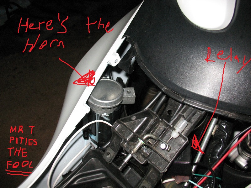

Here's two quick pic's of his Location (Ha! there's that Word again!
http://www.hondapcx.org/viewtopic.php?f=3&t=23
His scoot was a 2011, I'm thinking the 2013 is similar.
- image.jpeg (250 KiB) Viewed 6293 times
- image.jpeg (205.36 KiB) Viewed 6293 times

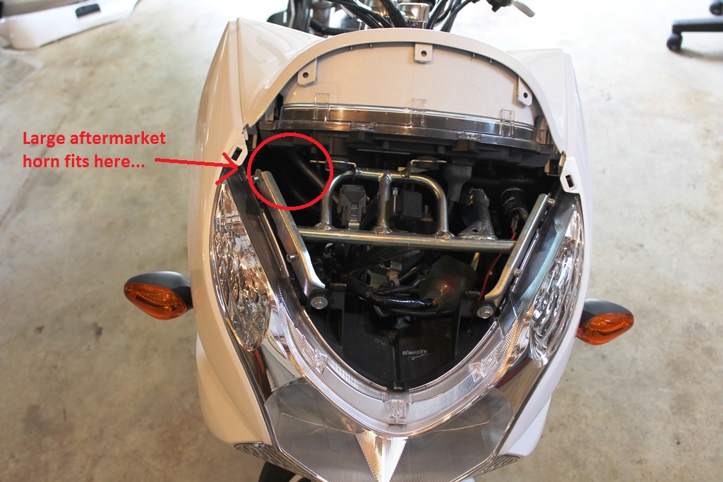

I have one on each of our 2013 PCX 150s. They are both in that area in front that is empty behind the headlight. (I couldn't get it to fit in the area Dave had put his.) Granted, I had to take the whole bike apart to get them in there, but they fit quite well, though I had to tie-wrap them in place so that they would not shift, if they could shift...doubtful since the area is tight in there. Maddiedog (Dave) helped me with the first one. The second one was just put in while I was rebuilding the scooter after the accident. I put the relay for the horn on the left side of the inner cover and connected the hot wire of the relay itself to the hot wire of the builtin horn. The hot wire of the Nautilus went directly to the battery, since that horn pulls way more current than the builtin one does. I kept the original horn attached as well because the Nautilus takes a second to spool up, and just tapping your horn may not give it the second it needs, though I have had no problem with that so far.
You CAN shove the horn into that area without taking the whole bike apart, if you work at it. We succeeded on the first one, but it was a challenge. Connect your extra wires first because you may not be able to reach them once it is in there. In the end it is all worth it. That horn wakes up those drivers who are not paying attention!

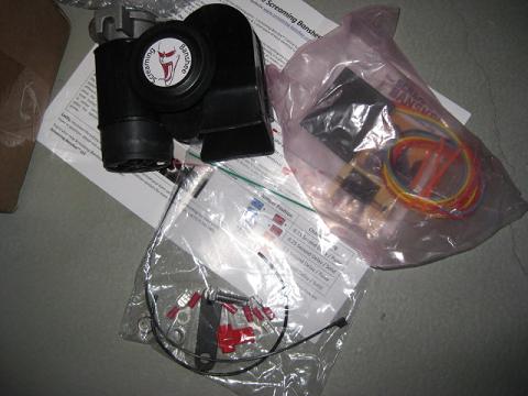

Re: where to put fat Stebel Nautilus Air-horn on skinny PCX
A photo I took of my Screamin' Banshee when I first got it. The top left of pic is the silver part that faces up in maddiedog's photo. The body of both horns create the bulk when fitting them.

Yes, I have read the Maddiedog post. I tried to position my horn where he did his, but she would not go. I think part of the porblem is that on the 2011 PCX the horn is on the right of the gas cap but on later models it is on the other side. I removed the left front panel, took out the horn, replaced the panel and tried to stuff the horn where Maddie had stuff it--no way.
The other piosition you mention I did not try. I found another before I could try it. where I am putting my horn is the only palace that was hospitable enough to allow it residence without any forcing. I put it right over the headlight. This position necessitates the leaving aside of an undercowl--my terminology--but its function can be replicated with a piece of 3 mil black plastic sheet taped in place. Over the sheet the meter cover fits even greazing the fat old horn.

I saw another of your posts wherein you describe how you positioned your horn. I had not thought of that place but when I stripped away the meter cover and undercowl, I knew my baby had found a home!Mel46 wrote:I have one on each of our 2013 PCX 150s. They are both in that area in front that is empty behind the headlight. (I couldn't get it to fit in the area Dave had put his.) Granted, I had to take the whole bike apart to get them in there, but they fit quite well, though I had to tie-wrap them in place so that they would not shift, if they could shift...doubtful since the area is tight in there. Maddiedog (Dave) helped me with the first one. The second one was just put in while I was rebuilding the scooter after the accident. I put the relay for the horn on the left side of the inner cover and connected the hot wire of the relay itself to the hot wire of the builtin horn. The hot wire of the Nautilus went directly to the battery, since that horn pulls way more current than the builtin one does. I kept the original horn attached as well because the Nautilus takes a second to spool up, and just tapping your horn may not give it the second it needs, though I have had no problem with that so far.
