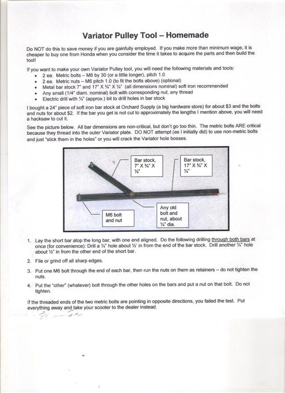

Hi, does anyone know the sizes of the holes on the faceplate. These are the holes where we attach the variator tool to stop it from spinning.
Alibally
Posts: 1761
Location: Edinburgh, Scotland
Re: Size of holes on pulley face plate
Post by Alibally »
You can use m6 bolts. That's what I've done.
