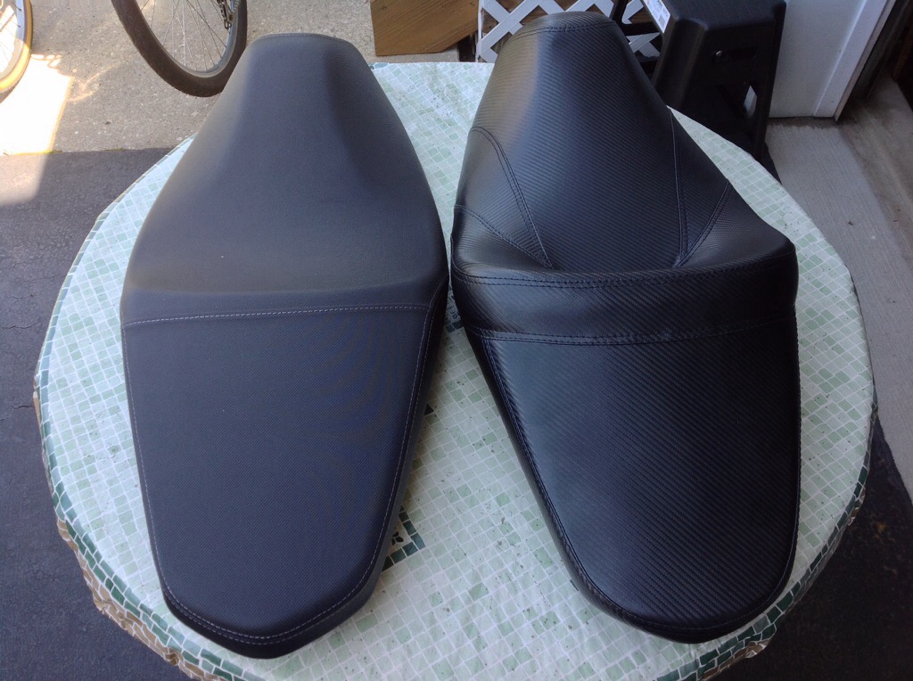

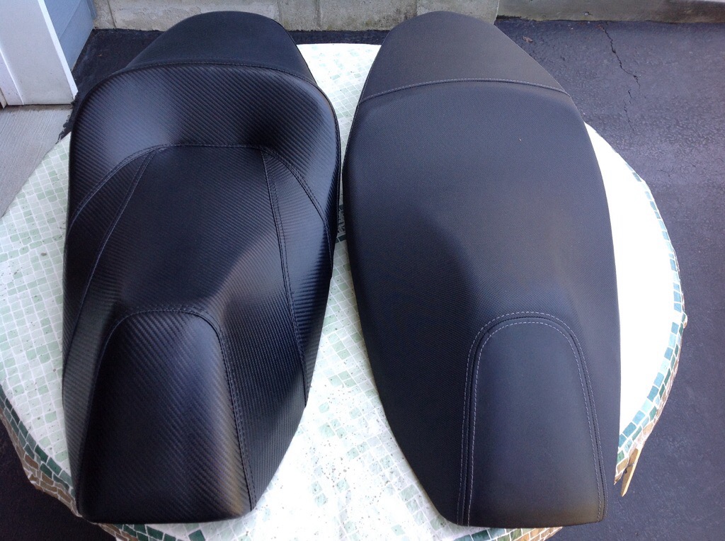

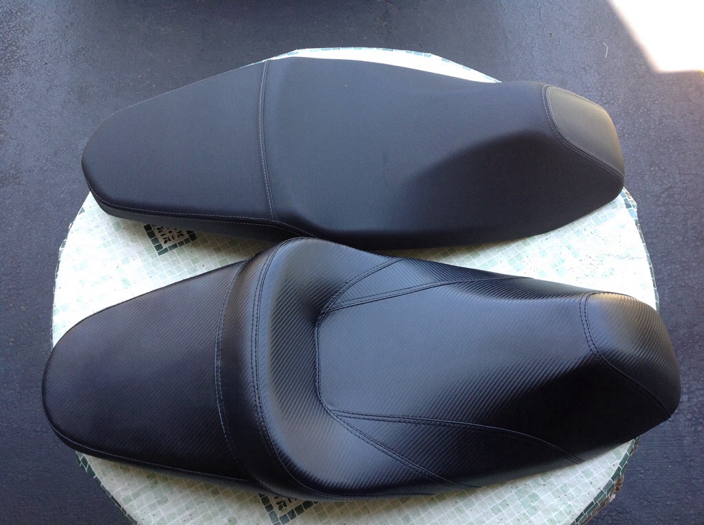

WOOT! I just got me a New Saddle!
History: Member Dave Bo offered his two saddles up for sale in a thread he was chatting in. I happened to have seen it and PM'd him. Luckily for me, Dave still had the one that I wanted.
Being only a few States away from each other, we made the transaction happen in less than a week. I have it, and it's so close to being New! I just installed it this past weekend and took a brief 2 mile ride.
It Felt soo Good. Did ya'll hear my Butt sighing, Ahhhhhhh
Pictures:

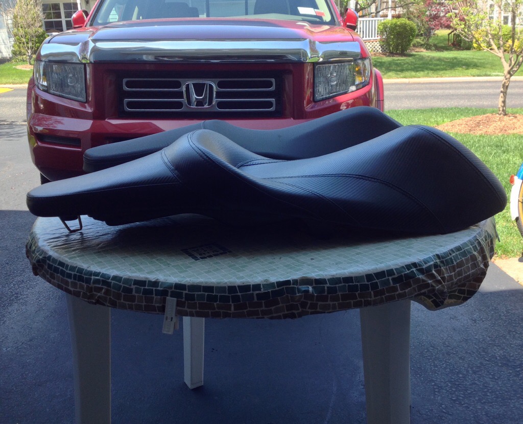

Side by side of Stock Seat and Custom Seat#18 (I believe was originally purchased from https://bikerzbits.com/honda/pcx/seats)....

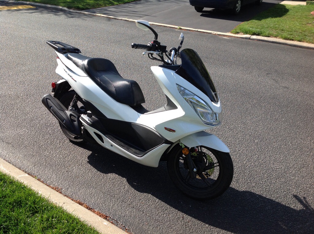

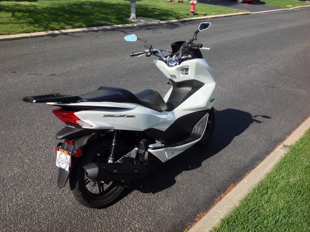

and WN in All Her Glory! :P

Great pic review, after trying 2 other seats, this is also the seat I use, a year or so in, it still looks and works great.

Cool!
Does it have better padding?

My wife's custom seat looks similar....actually the only differences are that it is for the 2013 PCX, and the stitching is red. It is very comfortable. The one that I have one like it that has been custom made with the back brace quite a bit further back so that I can put a gel seat pads under me and then I added another temp brace that is higher which braces against the tail box. I did this because of my back surgeries, but the seat is oh so comfy.

Got a picture of the stock seat? That's what I use--only customization is where it got a little tear from using the handlebar to keep it open.

@ Glen, thanks! I can understand why you're still sitting in yours ;)
@ DR, yes I can feel more padding. A whole bunch more? No, but you know there's more and it feels better. The seat "pocket" is wider and the front end dips into the pocket where the backrest fits me just right. I'm a happier PCX rider for sure!
Oh, and the vinyl may Look slippery, but I'm Not sliding whilst accelerating or braking. I look forward to a longer ride for the truest test results. But...I'm thinking Not much will change my body n bums sensor opinions ;) Been having lots of bucket rain lately and it will continue, the weatherman does say.
@ Mel yep, for taller folk I can understand bumping the backrest a bit further back. I have a bad back too Mel. No surgeries yet, almost....it could happen one day. Having a backrest is important, so is its placement and height. I get it, I now have it! Yippee...
The rear rack is the Honda recall rack. I'm not using a topbox as of yet. I will make the exchange for sure when my number comes up :D

@ bash, okay you've got me confused. I got a pic above of the stock seat. So what is it your asking or hmm...perhaps telling me? Let's SEE your seat. Come on now, sharing is Good :P

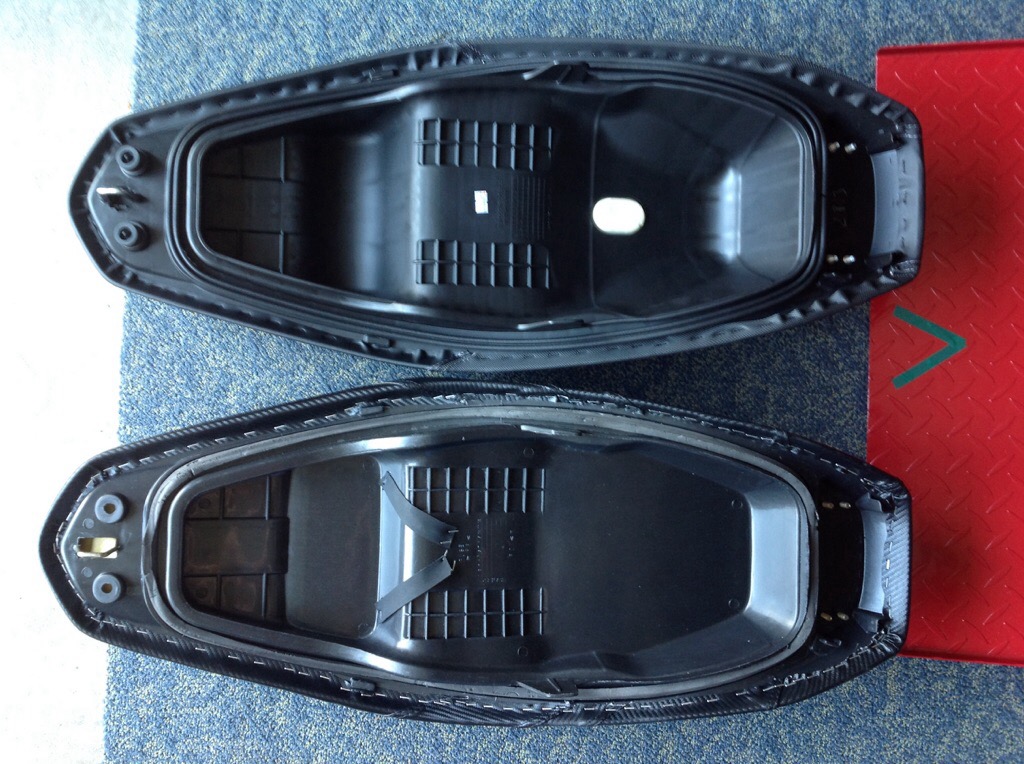

The other day I took my New #18 seat off. Holy smokes! What! Already?! Why?
Dave Bo who sold me the seat, was nice enough to include a new oem packaged under-seat weather seal. The seat came with a foam squishy type seal. See the bottom seat in the photo.
So off came the seat, off came the squishy seal and on went the Proper Weather Seal.
Well, that sounds easy right? It was basically but I'm a tad anal so cleaning the surface thouroughly prior to putting on the new was important to me. So After pulling off all the stringy type rubber cement I grabbed my bottle of isopropyl rubbing alcohol, a paper towel and cleaned the seal track out.
Heh! I want a Good Stick on the next fitting :P
The new seal comes a bit longer than needed, I'd say an inch or so. I liked that! It leaves room for error and for extra should your seat require it. Okok blah blah blah...
Both the old and new seal have a thin tape on the backside, a self stick n seal you could calls it. You must handle it carefully and remove the waxy cover backing as you go along applying it. You don't want it to stick in the wrong places o_O now...do you? No. So, take your time. The payoff is worth it.
Wait....hold on, phone ringing. Important call, must answer. I will be Back! :geek:
Re: Got a Custom SEAT - Show' n 'Tell
......Alrighty I be back
I followed my own advice and the seal went on beautifully, no glitches. I trimmed an inch off at the end where the two met in the middle (at/near the rear latch). TahDah, Finis!
Ah Not so fast WhiteNoise, you forgot about those two seat bumpers! They're missing on yer new seat!
I see two empty holes staring at me! Oh yeah, okay I'll pull them off the old seat while I'm here ;) and re-use them. Cool!
I gave each bumper a slow twist and pull and out the holes they came. Yes, of course I was nervous. I didn't know what was on the other side of them bumpers (geez, can you see it? :lol: )
I didn't want to tear them. Okay we're past that Drama!
I got them both out without a blemish! Double TahDah!
Getting them into the New seat? You just had to ask right? No biggie but....
I did have to shape the holes that receive them (see pic above of New seat's holes).
Those two holes were "roughed in" and a wee bit too small of an opening (you Don't want them too big either, else the bumpers will swim in there :P ) So I got my round file and carefully filed bits off...little at a time till they looked a match to the OEM seats holes. Perfect, did it, I was happy. I cleaned the area and slowly pushed them in with a twist and Voila! Both bumpers were in and seated.
I grinned a proud grin, returned to the garaged where me scoot sits spoiled upon her lift and adorned her once again with a brandy New Saddle. She flashed her lights afterwards. Guess that means she's Ready To Roll! 8)
Well that's All Folks! Do not hesitate taking on the job of switching seats. It's A Fun to Do Mod and one that will make your arse and back sigh of R E L I E F
