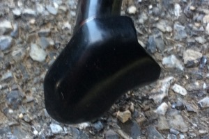

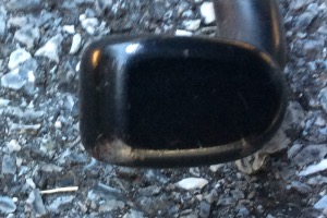

Yep. Tbh, I've used dozens of different centerstands on various bikes and few of them have what I would call a non-skid surface. In fact, I happen to own two scooters and despite the fact that both have "shiny black" surfaces (something we call "paint"), my foot has never slipped off either of them, nor off any of the shiny black center stands of bikes or scooters I've owned or worked on, simply because I follow the method listed above, and lean slightly over the bike to let my weight do all the work. When I worked in the IT world, we used to call your type of issue an "ID-10T" error.k2apache6.0 wrote:GN2 is right as usual ..Perfect description of how it's done, right here.gn2 wrote:The solution is to learn how to put the scooter on the stand properly.
Left hand on the handlebar, right hand on the grab handle and right foot on the centre stand.
Push the stand down and make sure both of the stand feet are in contact with the ground, then put your weight on your right foot.
You don't lift the scooter with your hands but with your weight on the right foot.
If enough of your weight is on your right foot and you are wearing the approproiate sturdy footwear for riding a scooter, your foot will never slip.
See the pics below and tell me how one is less slippery than the other.
