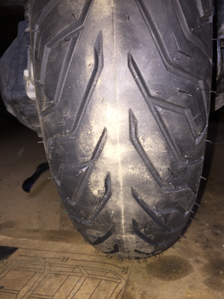

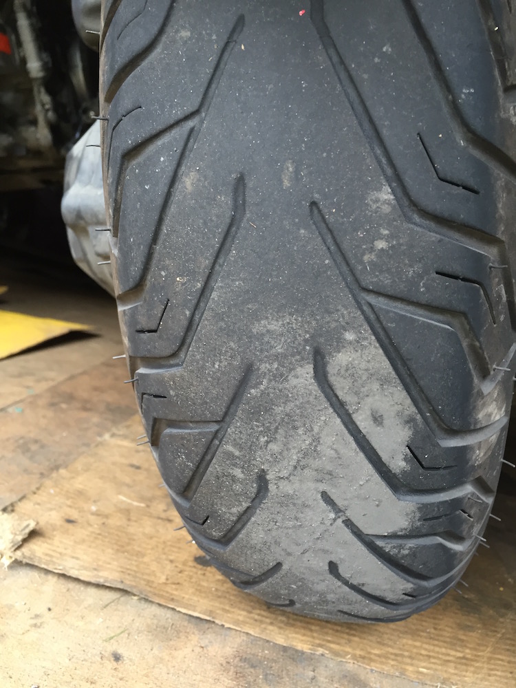

I think I am due but my Scottish ancestry says, "Hey they still hold air, lets go some more"
Here is before and after pictures.

If it wuz me, I probably wouldn't change that rear just yet, but I would order up a replacement.

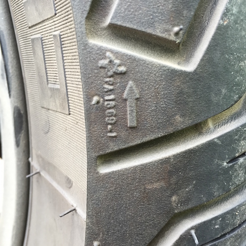

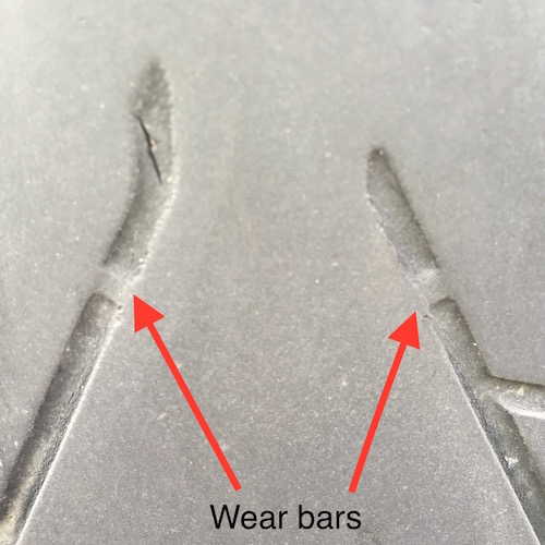

OK sold the DR650 for next to nothing. I went to Chilliwack to put the cash into my Visa account. I got there too early so I bought a Starbucks and sat on the ground to have a good look at my tires. I found the wear bars. They are very small. There is a Michelin Man and directional arrow on the side of the tread (Not the sidewall). There are two very small wear bars in the groves near the centre line.
I am now due for a rear tire. I am going on a 600 km ride on Sunday to Lac La Hache. If I return alive I will get a new tire.

Thank You davenowherejones that's how we do it in PCX-4Z forum
Now we know where those wear bars are on Michelin and exactly what they look like... before they are gone.
