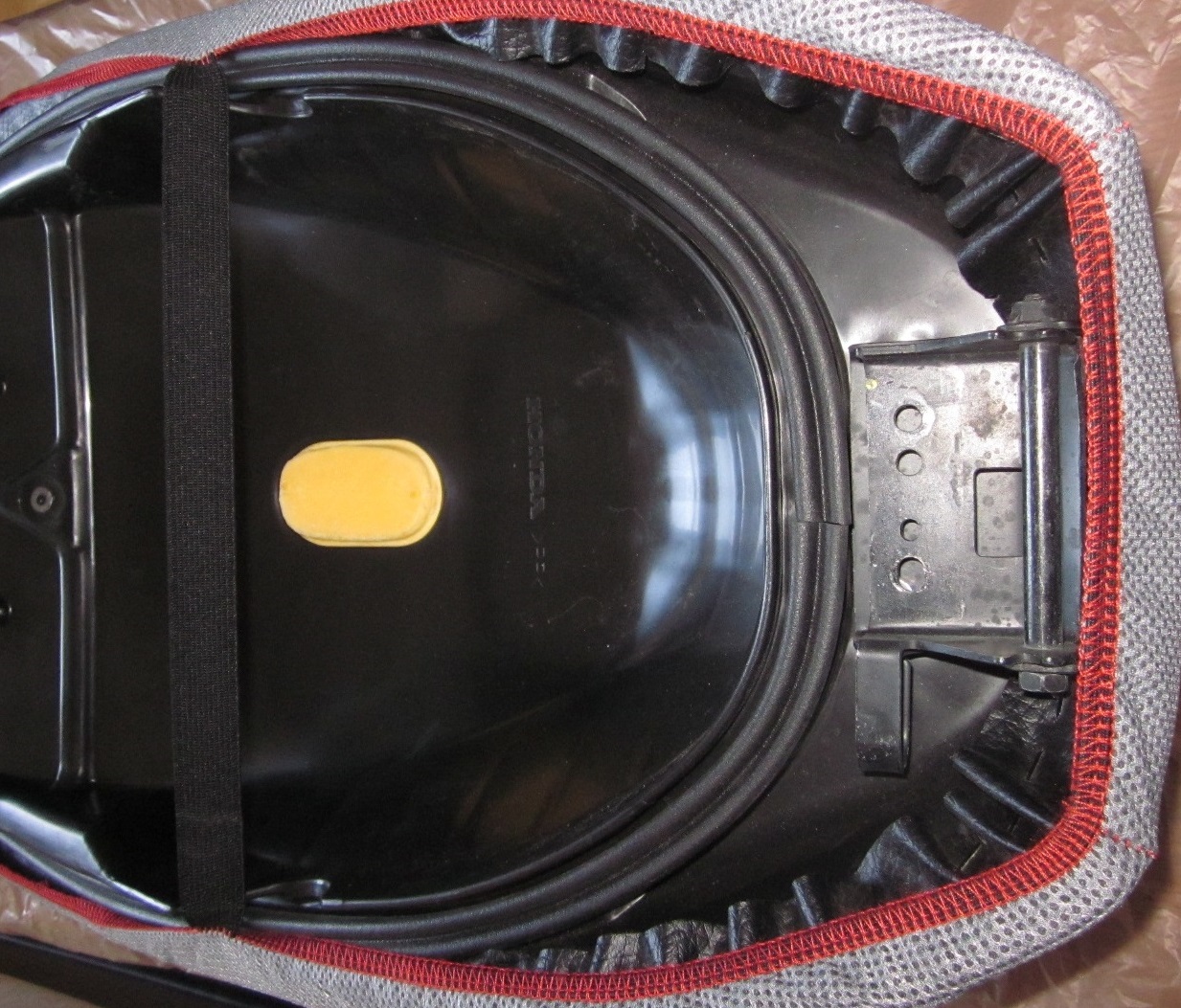

Flip it over and it looks like this:

Put the Givi cover on while keeping the gel in place:
Then reinstall seat onto the PCX and enjoy:
