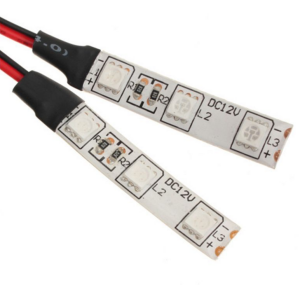

Recently, I was given four little strips of amber LED lights (they each have three LEDs in them, and are only about an inch and a half long).
Like these:
Along with a bunch of other people, I've often thought of swapping bulbs out to make the incandescents into LEDs, but I can't get a straight answer from either of the local Honda dealers about which relay I'm supposed to use, and nobody at the Advance Auto or O'Reilly's parts places has any idea which relay I should use to stop hyperflash. In fact, one of the Honda dealers kept trying to tell me that they'd never heard of such a thing as hyperflash, and that I should just get another stock relay that's just like the one I already have. I know that won't fly.
Anyway, I had the idea of possibly adding in these little strips onto the body panels as additional turn signal lights. If I just add LEDs to the existing circuit, as in tapping into the existing signal wires, that shouldn't cause the existing lights to go into hyperflash, should it? I'm not replacing the stock incandescents with LEDs, so the resistance won't change in those bulbs. I'm just adding in extra low-power lights. That shouldn't change much in the circuit, should it?
I'm thinking of encasing them in transparent shrink tubing, and using double-sided tape to just stick them onto a body panel.
Anyone have any comments or suggestions?
I don't really want to have to take everything apart just to find out that it won't work the way I think it will, so has anyone done this or anything like this?
The ever-popular LED add on lighting...

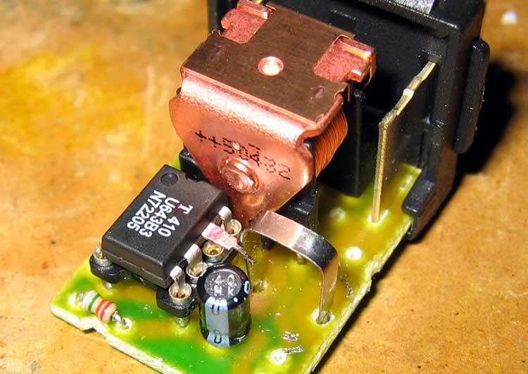

I haven't had the need to do this on my 15 but if you know where the flasher is located and you can get to it you will have a couple choices. Maybe someone knows how much trouble it is to find the flasher on your 2012 PCX model.
One option is to open a sealed flasher and clip a prong off the chip inside, reseal the unit and you are good to go with LED's. That second prong you see in orientation to the stamp on the unit. This is silly but people are thrifty and clever and it works with standard flashers and LED's. It will slow the rate of flash to normal every time.
I just went to a local auto parts store and bought the Ep36 flasher (it must say 3-6 led lamps on it). Then I swapped out incandescent turn signals to LED's on a (street bike) again no experience with this on a PCX sorry.
I recommend you buy the Ep36 (maybe 3 bucks) find your flasher (should be accessible) but wait for more opinions.

The turn signal relay is designed to handle a certain number of loads (bulbs). This is why if you remove a load, like when one of the bulbs blows, the other two lights on the circuit blink faster. If you add another load, they will blink more slowly. Changing your blink rate may impact the scoot's ability to pass inspection when the time comes (I know it will here in PA).
A new relay, tuned to handle more lights, or a second relay for the new lights, would be your best option.
