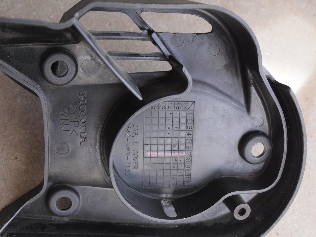

So, here's my update to my Yuminashi variator upgrade. If you go over this post, you'll read about a belt failure & the aftermarket manufacturer's comments. Based on those comments, I've modified my PCX's variator covers.
Starting with the plastic intake, where the air enters the belt chamber:
Original, interior
Original, interior

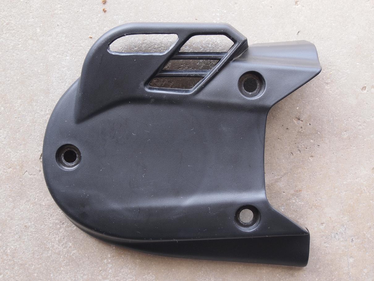

I added an extra intake "window" at the top where it's protected by the body panel, and a slot at the lowest point where any water intrusion could drain before being pulled into the belt chamber:
Modified, interior
Modified, interior

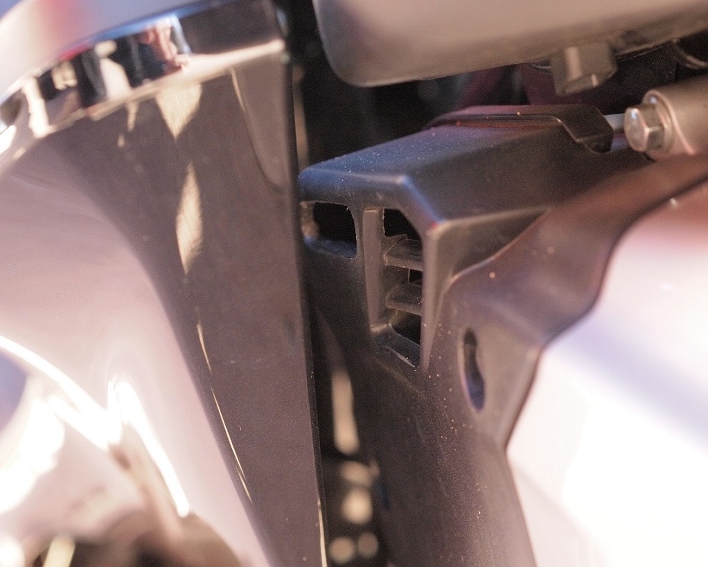

How it looks from the outside:
Modified, exterior
Modified, exterior
How much it's covered by the body panel:
Installed, exterior
Installed, exterior

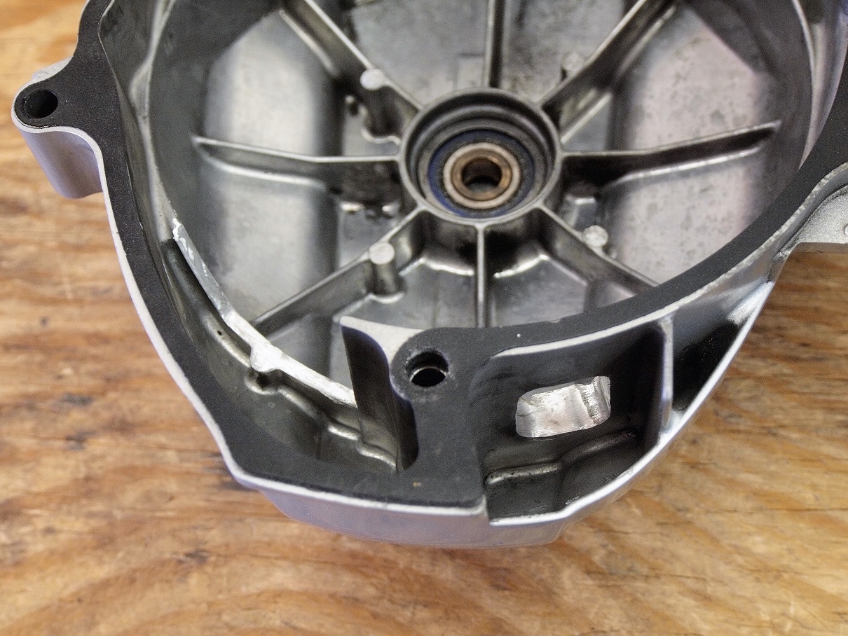

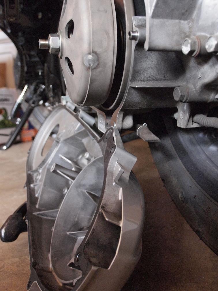

Next, I looked at the aluminum housing, and decided to modify only the cover:
Original
Original

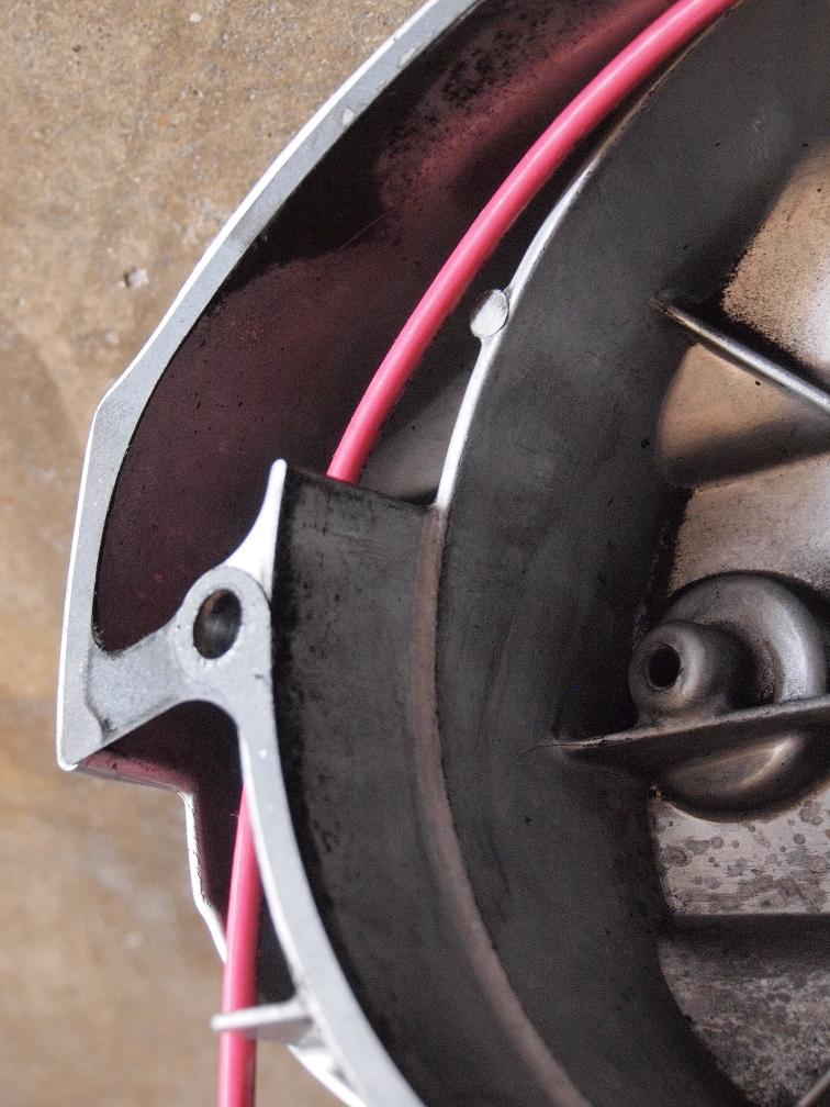

The red wire traces the air path as it exits the belt housing (same sized opening mirrored on the bike's casting):
Original, interior
Original, interior

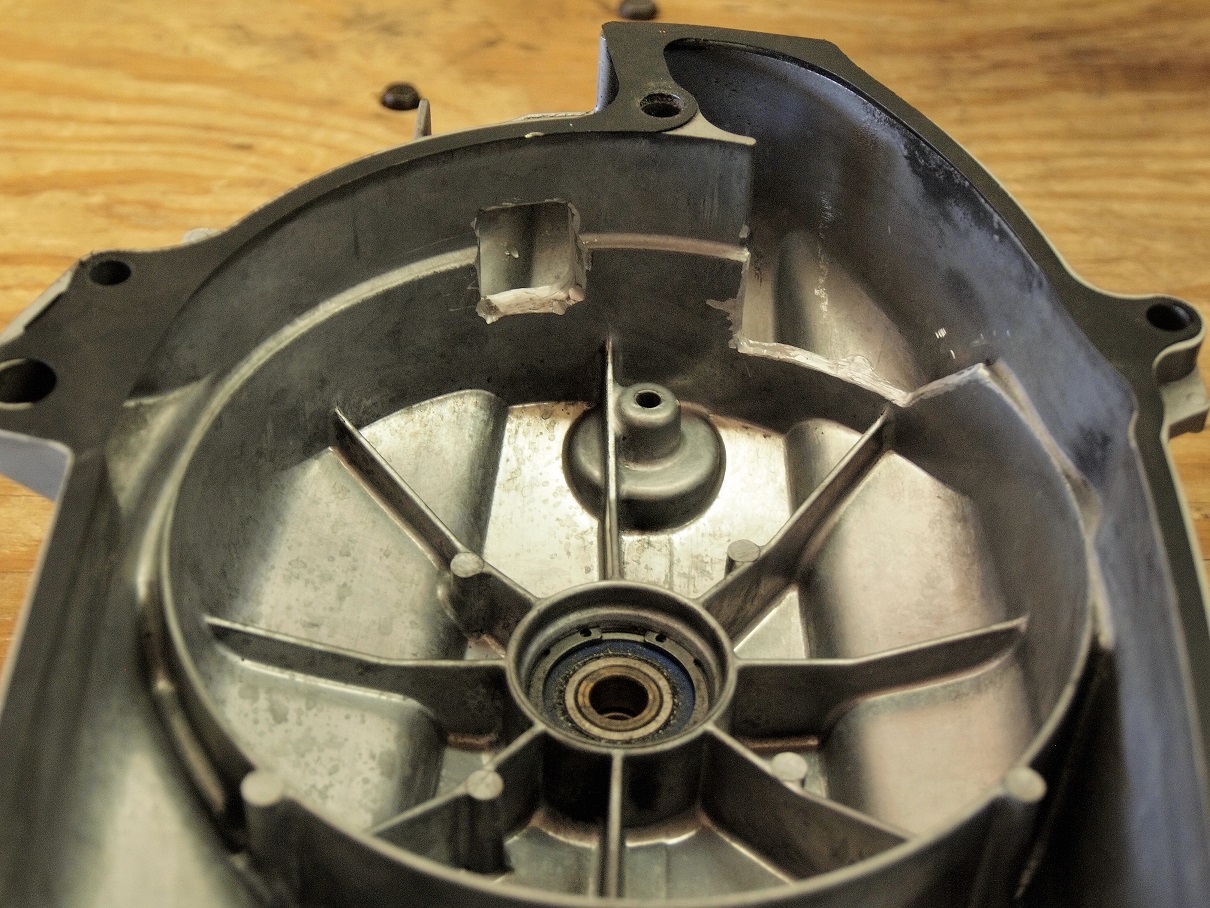

For this first pass, I decided to keep the new exit window small enough to be protected:
Modified, interior
Modified, interior
From the outside, you can see how little is exposed to the elements:
Modified, exterior
Modified, exterior
Assuming I have no problems over the Winter, I'll examine both the new intake and exit windows for telltale water intrusion residue next Spring/Summer. If I don't see any issues, I'll probably enlarge the exit window at that point. I don't plan on adding any more intake openings.

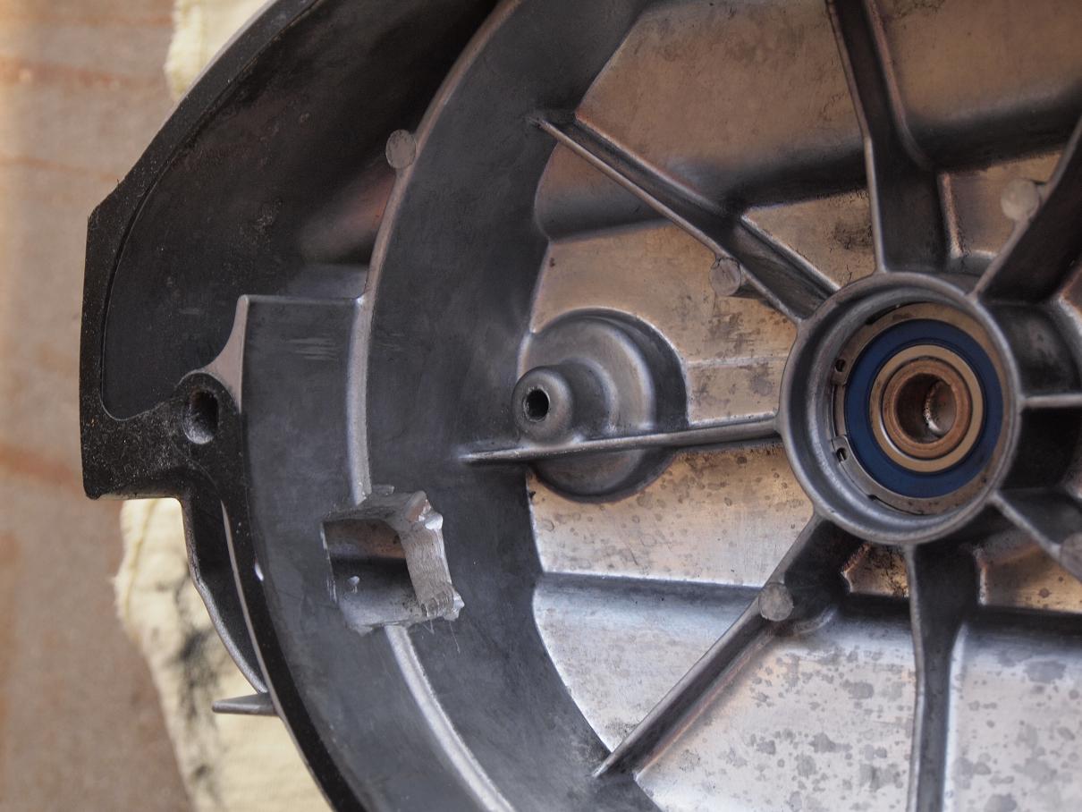

I added another airflow window to the drive belt housing. In reality, this is probably the exit window I should've done the first time!
Not only is it larger and better protected from water splash, but it's a lot easier to make!
Since I haven't had any water intrusion problems with the smaller/lower window, I won't cover it over just yet.

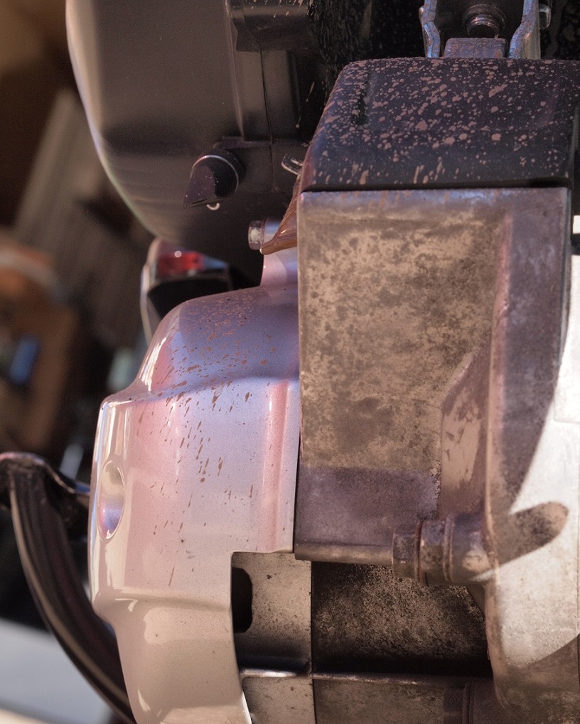

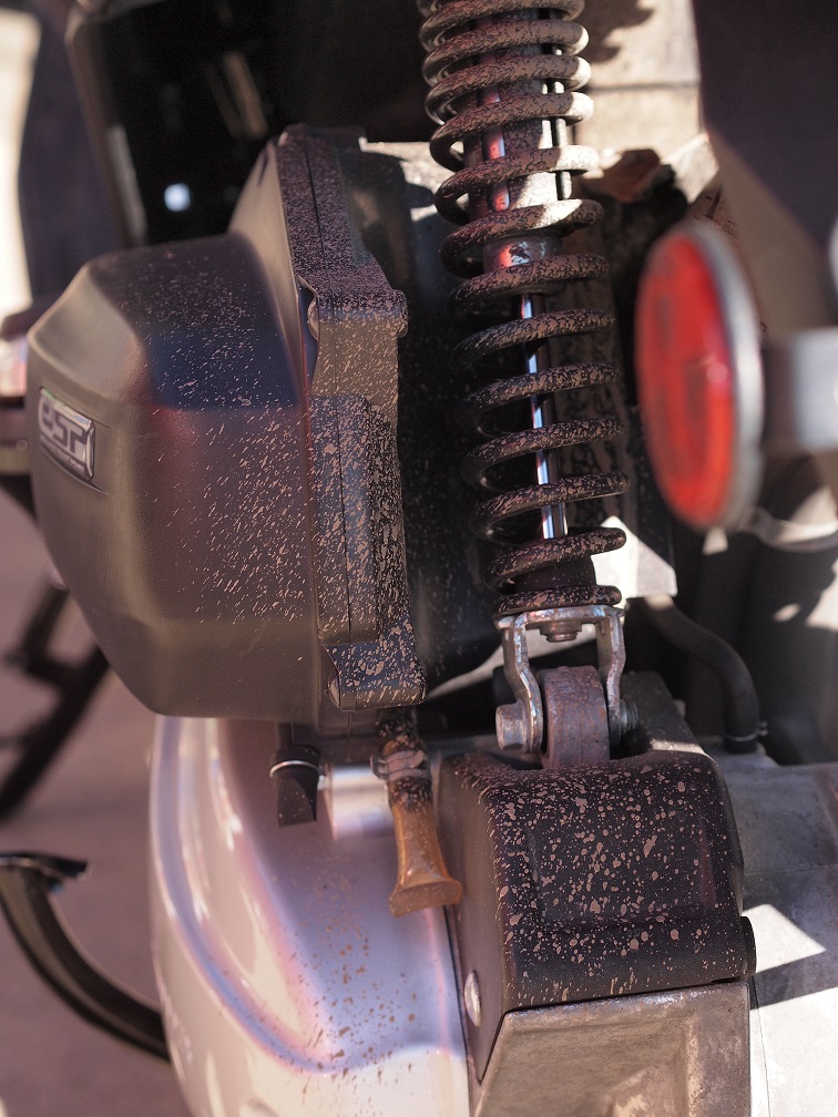

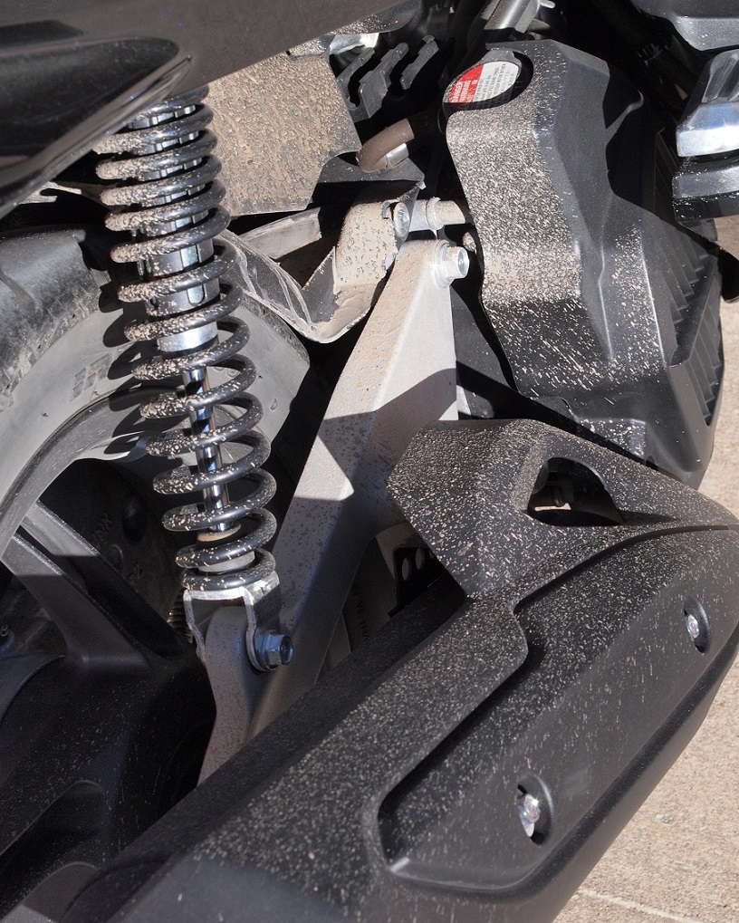

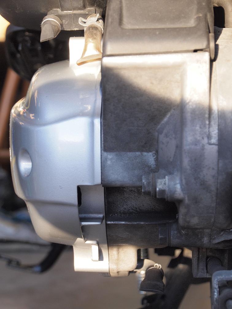

Update, splash pattern:
I took the scoot out between snow storms to run some errands (we had one day in the mid-60s). Since I normally avoid riding in the wet (I'm still on the original IRC tires, and I don't trust them on wet pavement), the snowmelt gave me some good visuals on splash patterns. I was happy to see that all of my added drive belt vents were splash-free.
Most of the splash was on the exhaust-side
Less splash on the drive-side
No splash around the exit vent I made
No splash around the intake vent I made
PCX150Rider
Posts: 1832
Location: Old Saybrook, CT
Re: Yuminashi Variator Upgrade to 2015 PCX150
Post by PCX150Rider »
Good pics. We can clearly see the area around the penetrations is clean.
Sounds like you are getting about 10 MPH more and the fuel economy hasn't suffered under usual riding conditions.
Nice to have the extra speed on tap. It's not stellar acceleration from 55 to 70 right? More that once you are up to speed you can keep up with the flow of traffic on the highway?
Watch out for the crazys doing 80 in the 65 zones though! 8)
