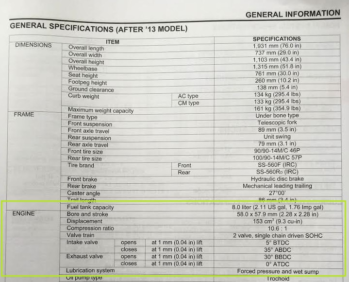

Re: Need help on camshaft specs
Unfortunately I only have the 2013 service manual so I have the same settings as you do. Sorry. I am guessing that what you want is the specs on the 2015, which should be an LED version. Homie, don't you have a 2015 manual, or at least the addendum for the 2015?
- 2015 manual.jpg (41.17 KiB) Viewed 7378 times
- specs.jpg (157.54 KiB) Viewed 7378 times

Hi Homie thanks for helping. As I can see the specs from your manual is the same as mine, not a good sign. However, I see that your manual specifies the piston bore is 58mm which is strange since all the LEDs I know have 57.2mm piston to drop the cc down to 149 due to import duties problem with bikes over 150cc in some countries (153 got taxed hard in my country). Can you go one step further and check if your manual is for a LED scooter? That'd help me a lot. Thanks in advance for helping a brother out.
Cheers.

Here you go, sorry I didn't check back on this faster. Yes this first release SM April 2014 does cover the 2015 Honda PCX150 LED model. "This manual describes the service procedures for the PCX150" No mention of the 125cc models in my version. Feel free to ask for more information/pictures from the SM anytime.

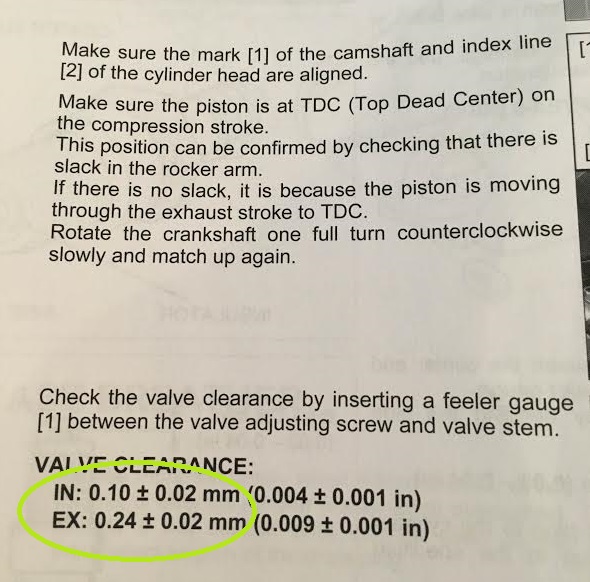

Hey can you recheck the valve clearance value for me?homie wrote:Here you go, sorry I didn't check back on this faster. Yes this first release SM April 2014 does cover the 2015 Honda PCX150 LED model. "This manual describes the service procedures for the PCX150" No mention of the 125cc models in my version. Feel free to ask for more information/pictures from the SM anytime.
Replacing a fuel pump and running around finding someone to mount my new rubber today, raining so its a good day to be down
In my manual it's 0.1mm for the intake and 0.24mm for exhaust
............. 2015 Honda PCX 150 per the service manual
Thank you very much. I notice there's no Thank button on this forum. Strange.homie wrote:............. 2015 Honda PCX 150 per the service manual
