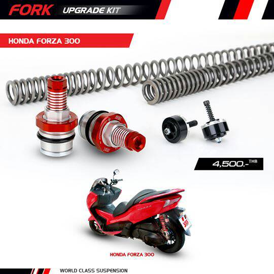

Re: Front suspension?
You could try Ohlins or YSS fork upgrade kits to solve the soft front fork.
Currently using YSS Fork upgrade kits. Makes a world of a difference in handling, a little stiffer but makes taking high speed corners with more confidence.
