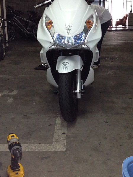

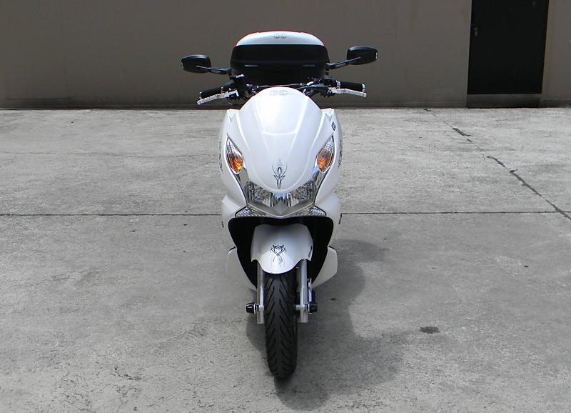

easyrider wrote:...... I would like to see a pic of another front city grip on a bike and check it...........
Here a couple ...
