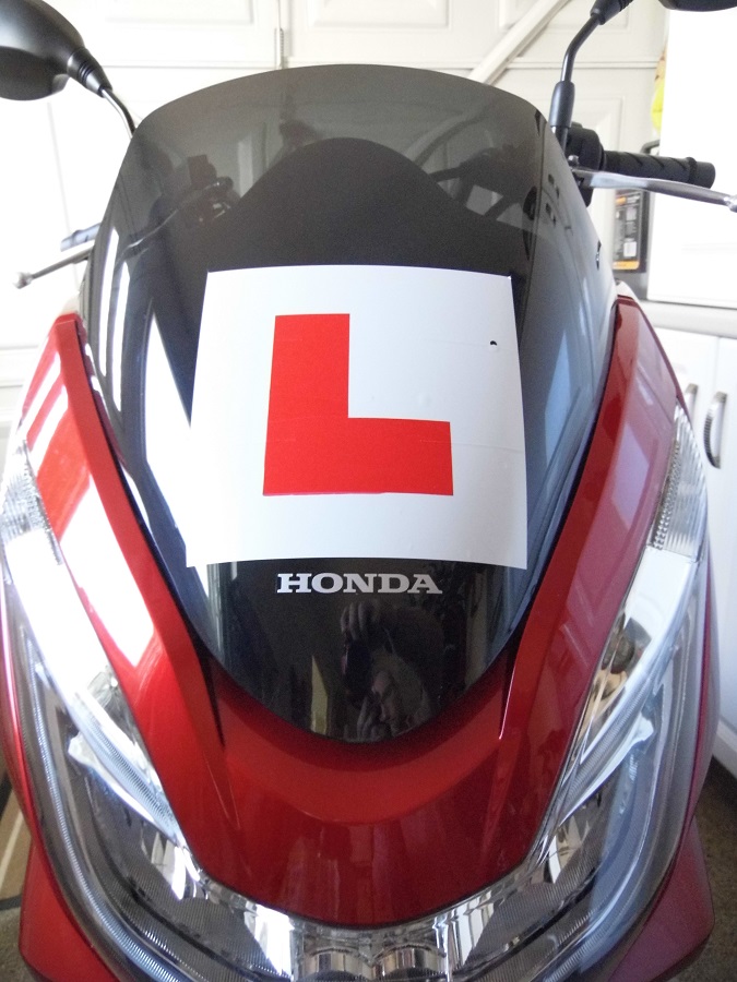

Recently fitted a new screen to PCX, a couple of members asked for description and / or photos, so here goes.....
Standard screen as fitted. Found it a bit too low, so purchased a Givi screen.
Givi Screen (3).JPG (187.14 KiB) Viewed 12729 times

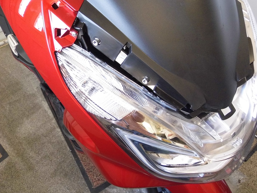

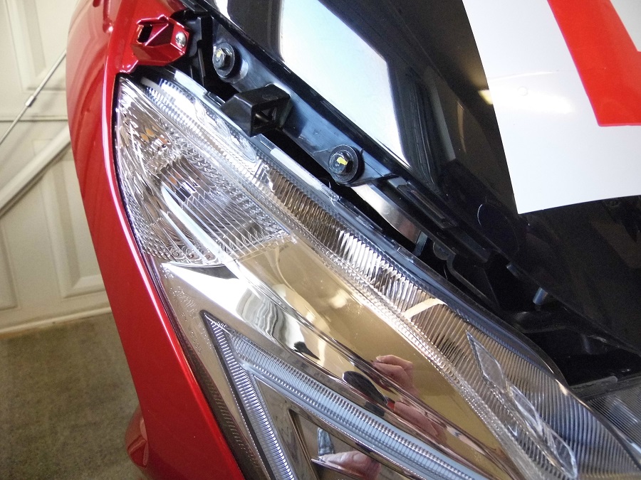

Once the grill is removed, two bolts are exposed on each side.
Givi Screen (8).JPG (257.97 KiB) Viewed 12730 times

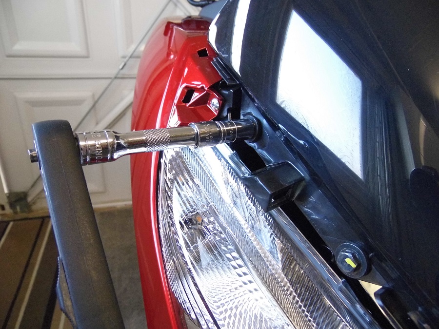

10mm socket with extension so not to scratch the bodywork, all four bolts came off easily.
Givi Screen (10).JPG (248.91 KiB) Viewed 12729 times

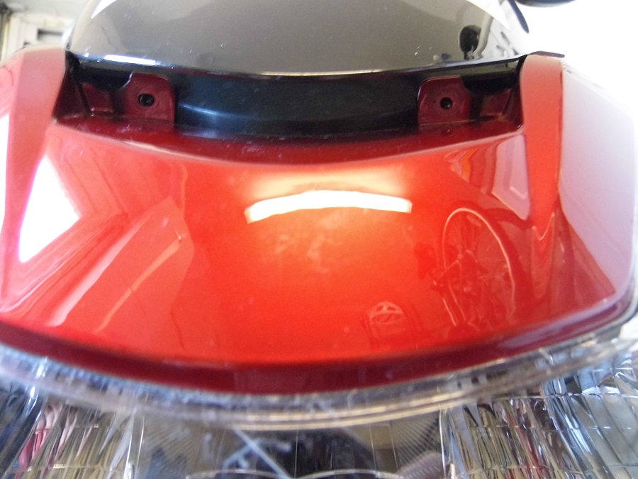

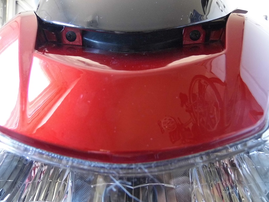

Once the four bolts are removed the screen easily bends and comes off these four silver retainers. When the screen was removed I took the chance to clean this area as it is impossible to do so with a screen in place.
Givi Screen (15).JPG (268.58 KiB) Viewed 12730 times

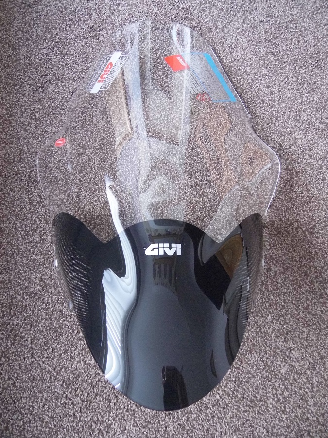

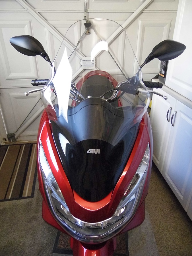

Screen unwrapped and inspected prior to fitment.
Givi Screen (20).JPG (374.13 KiB) Viewed 12732 times

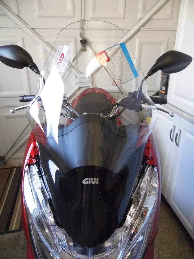

Screen fitted in place, two holes on each side of the screen marry up to the silver retainers on the scooter, original bolts refitted. Lined up perfectly and took seconds to clip in place.
Givi Screen (21).JPG (216.68 KiB) Viewed 12731 times

Grill put back in and screwed in place. Takes a bit jiggling around and care has to be taken so not to scratch the headlight, but once lined up it slots back really easily.
From start to finished the whole job took about 15 minutes, including taking photos, without the photos, 8-10 minutes.
Really easy job with only a screwdriver and 10mm socket / wrench needed.
Hope this thread is of use to someone!
Givi Screen (24).JPG (225.65 KiB) Viewed 12728 times

Re: Givi Screen Fitment
NICE!... tell me you don't have to put the big LOSER decal on that, it would ruin the plastic.
Chapel77
Posts: 72
Joined: Thu Nov 24, 2016 4:08 pm
Location: United Kingdom
Post by Chapel77 »
Legally yes, but............
Living the Honda Dream!

The angle of the photo doesn't help, but obviously it's not in the line of sight. Will probably attach a hard 'L' plate to my front fork.
Agree they are not the most aesthetically pleasing things to have on your scooter, but they do serve a purpose. Have two years to decide if I want to keep my PCX, as our CBT lasts for that period. Will probably do my test, if not can repeat CBT. Also have a car and a garage full of bikes so I'm in no rush to decide.
