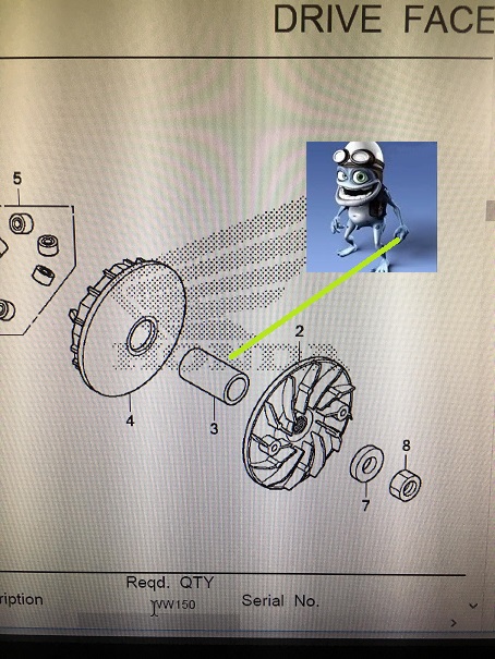

Hello PCX peeps,
I'm a former Ruckus modifier and Harley Rider, switched to the PCX for city riding.
Anyway, I know on the Ruckus we used to shave the spacer down a bit... This gave us a bit of a quicker take off/High speed. Just curious if anyone here has done this? if so what were the results?
Thanks!
Re: Spacer shaving?
Maybe give us a picture or two so we are clear on the part. I will assume you mean the boss bearing. This would bring the faces a little bit closer together and drive the belt higher at top speeds correct? Not something I would do because it COULD also cause constant contact on the belt when idling, thus premature belt wear.

Homie,
That is the correct part. In the ruckus world it was just known as the variator spacer. Thanks for the feedback.

You are most welcome, I haven't seen this mod carry over into PCX/Forza forum but I only joined with a 2015 model. The Ruckus has been around long before my time with scooters. You do tempt me to order a boss bearing and do some trial runs as I have a used belt that I could play with. If one was to "shave the spacer" about how much do you boys start with and how do you get a good square cut?

Homie, usually we would start with fractions of a mm and work until we found the "sweet spot" used a lathe to shave them.

Search for threads by Mgalutia, WaspMike and maybe even PCXdemon. I think they used to play with boss length when tuning.
From memory you would need to shim up the axle nut on the other side of the drive face after trimming down the boss.

Unfortunately I don't have access to the lathe or a Machinist to get a perfect part so I'm out but if any of you monkeys have the equipment why not tool one out and lets get this going. I want to break my best speed of 74mph.
