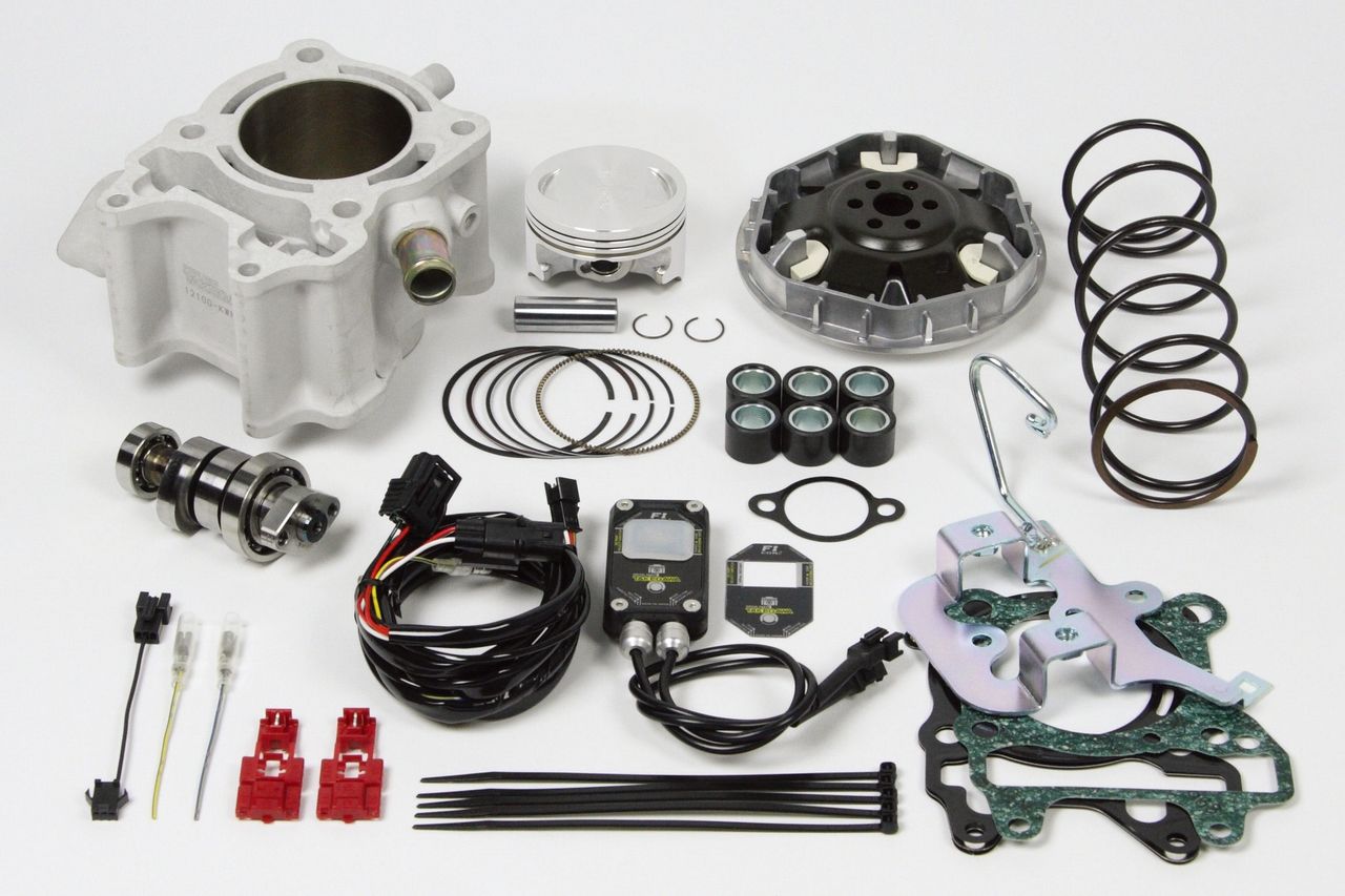

hi there,
i interest takegawa 170cc bore up kit (include high cam, Fi Con2 (Injection Controller)
if install this kit on my pcx, i've problem on crankshaft? (or large stress)
please let me know who installed it.
Pcxdemon
Posts: 932
Re: install bore up kit, haven't crank problem?
Post by Pcxdemon »
No problem on crankshaft. With Takegawa Vario,make sure you use stock Honda ramp plate and a .3 or .4mm washer on face pulley side.Honda ramp plate sits much deeper in the variator thus giving it a much better takeoff speed without the loss of performance anywhere else. You can get the perfect size washer/s on Webike made buy KN Planning under Pcx search.
