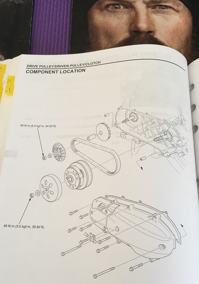

Did you find a service manual? I would not want you to work without an SM. There are things in it like (wet) torque's and exploded views so you get everything back together correctly.

I've got to get an electric impact wrench/driver and wanted to pick up the correct additional sockets while I'm at it. SM won't give nut sizes, at least I don't see them

Yes, impact wrench is the way to go BUT don't use it to TIGHTEN anything o_O ... buy a torque wrench and study the SM please

I've got one of those old Craftsman twist for the setting type torque wrenches. Kind of like fishing. . .you'll know you're at the proper torque when you feel the thing move/release.
It's most unfortunate that the SM doesn't provide the nut sizes. I can always wait and measure after I get it. I've got open ended and box wrenches in metric and sockets (but not necessarily in the sizes required to work with the impact wrench on the CVT).
