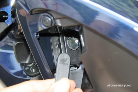

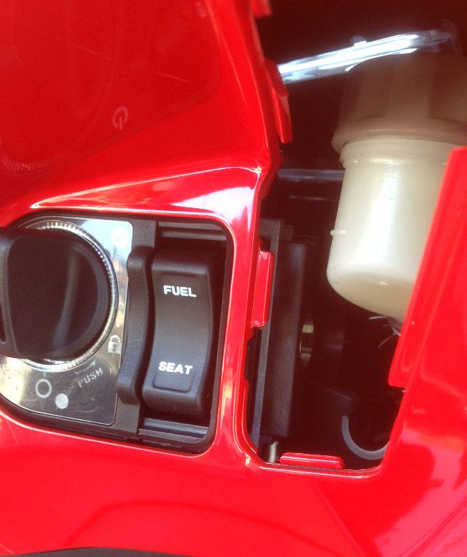

Take the cover down, insert the hex end of the key and turn it upright.

Thanks d.a.rous I managed to open it and solve the seat problem, now my remote stopped working too so need to solve it before trying, no more light on the remote and I changed two batteries without results ( cannot find cr3020 so had to try with cr2025 that was using before) maybe some electric problem on the key side.
