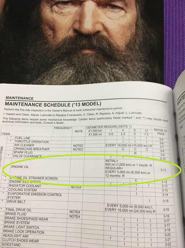

Because that bike has been sitting around for 4 years I would dump the oil now for possible condensation contamination and then again at 5k or 12 months which ever comes first per the service manual on a 13 model.
