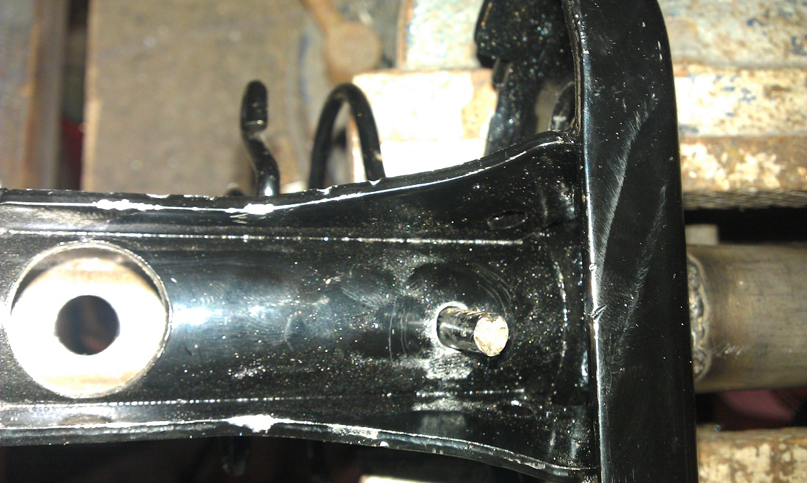

Moving on, put your new shaft into the thingy. For extra security I drilled a small hole in the thingy for a pin.
- IMAG0338.jpg (388.58 KiB) Viewed 6505 times
- IMAG0337.jpg (378.76 KiB) Viewed 6505 times
- dasshreddar
- Posts: 755
- Year: forzaruckuspcx
Re: How to install a mountain bike stem.
Now weld in the pin and weld the parts together like this.
