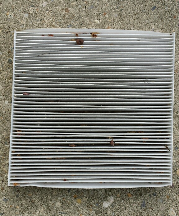

Today I changed the cabin filter in my truck. Shades of Excitement! :geek:
I found a collection of debris snuggled inside. From bugs to chopped up leaves and flowers, also plenty of sand in the base of each pleat and ah-choo! Dust and Pollen. The last change I did was in Aug 2014. I was surprised to see that it wasn't worse.
So when is the last time you changed yours?
Consider this a reminder, if you will. Allergy folks you might want to get this done ;)
